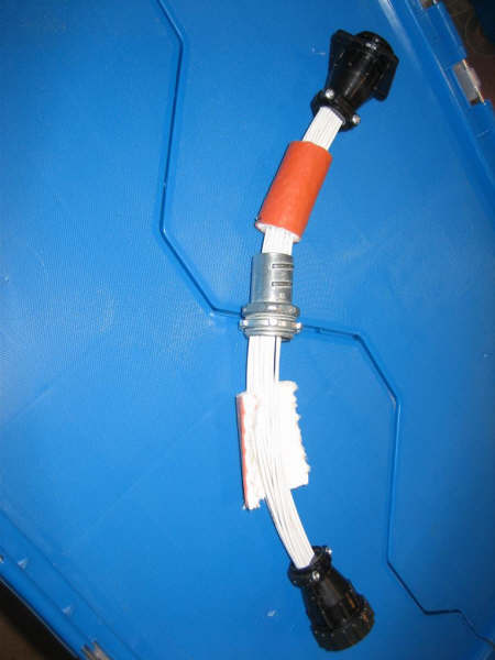

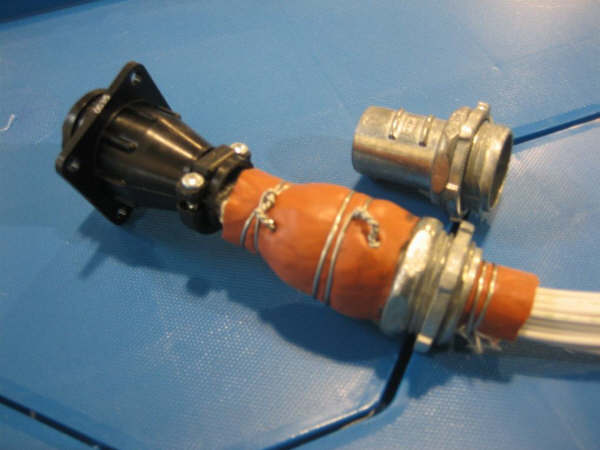

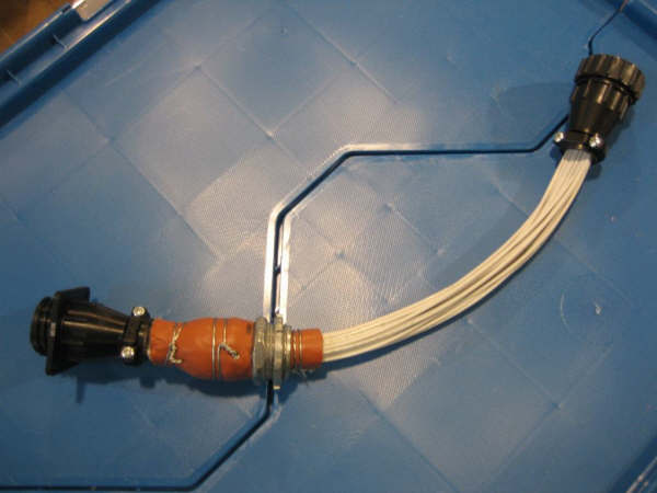

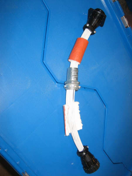

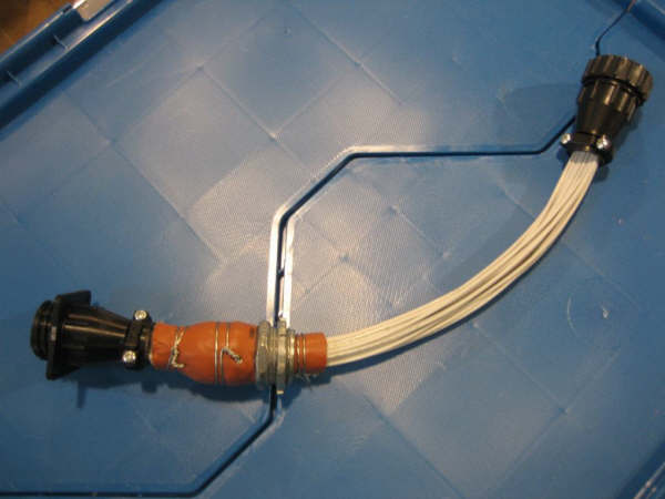

.ExternalClass .EC_hmmessage P {padding:0px;} .ExternalClass EC_body.hmmessage {font-size:10pt;font-family:Tahoma;} We used a similar fitting but it has a barbed extension to clamp flexible conduit over it.
$2.50 ea from Lowes Aviation dept.
See photos attached

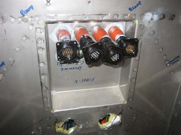

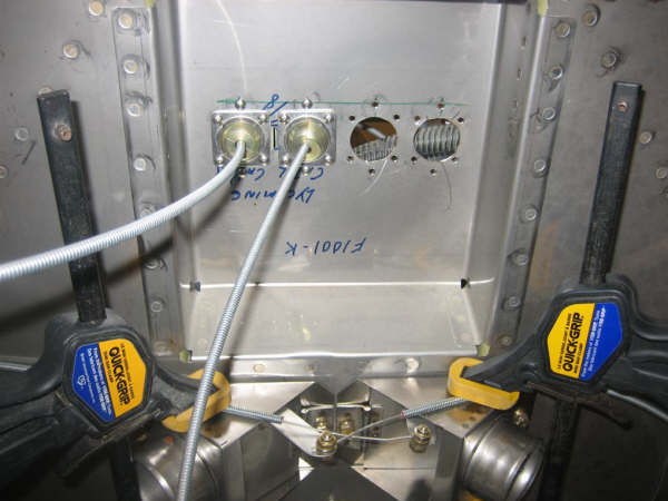

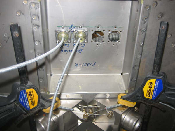

We used 4 of theses on our RV-10 mounted in the firewall center recess.
The wires pass thru the bulkhead fitting with a connector on either side.
The wires are wrapped in fire sleeve and potted with sealant similar to the SafeAir design.
After the pass-thrus are in the firewall the FWF side connectors are mounted on to the back side of a SS plate which covers the recess.
Eric Parlow
