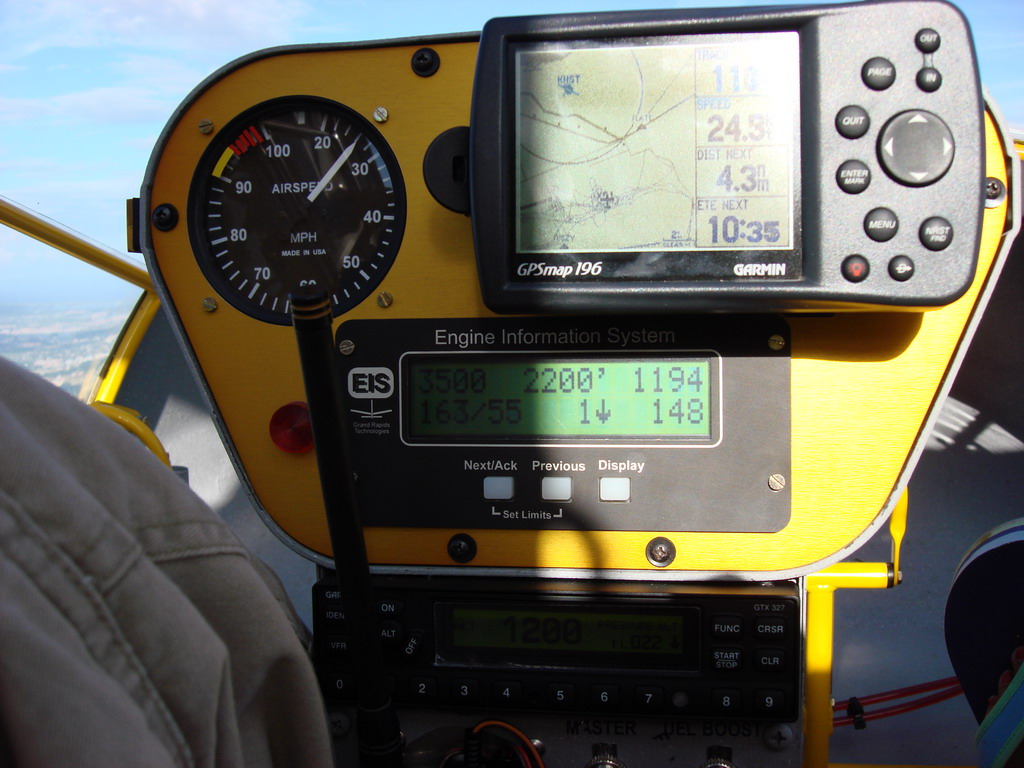

Ok, you all saw what VG's did to my runways Now, on the serious side, here is a picture I took of my MK III Xtra panel with the VG's on the plane. I had two people, my wife and I, and this picture was taken at idle power, level flight just before the stall break, I dont remember if I had one notch of flaps in or clean on this one, it does not seem to make much difference in the stall speeds. You can see engine RPM of 2200, and a 100 FPM sink rate, and if you look outside, you can see the plane is still level, and under control. I did no pitch ups, or any wild things to make the airspeed go down suddenly, speed is also reading on the GPS which has a bit of a lag. This stall was from level flight, slow speed reduction, power off. The instrument readings speak for themselves.
I'm not trying to talk anyone that does not want VG's into getting them, but this is good information for people that may be considering them and are wondering what the effect on performance might be.

One Correction, I was at 3500 RPM to maintain level flight just barely above the stall break with the 912-S ... I was at 2200 feet if you are familiar with the EIS readout.

You seem to be mistaking your altitude with RPM which reads 3500.
Jp wrote
" You can see engine RPM of 2200, and a 100 FPM sink rate, and if you look outside, you can see the plane is still level, and under control. I did "

That is correct,
I corrected those items in my second post. Engine Speed was 3500 RPM, and Altitude was 2200. I noticed that just after I hit the submit button on the first post, but it was to late...
