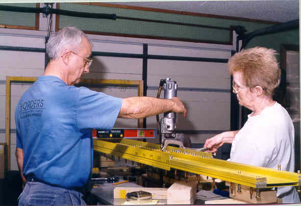

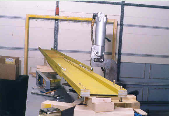

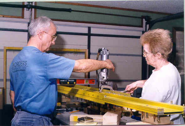

Back in about 2000 or 2001 when I built my RV-6A spar, Van rented a
pneumatic squeezer for the large rivets. When properly set up, it set
those rivet s perfectly with little effort. They were exactly repeatable.
I looked at Van's website and could not find any mention of that
squeezer. It was sent from user to user because of its heavy use rather
than returning to Van's after each use. If you can find a source now
that rents them it is a super way to set those spar rivets.
I've attached a couple of pictures of the squeezer in use.
Richard Dudley
RV-6A flying
