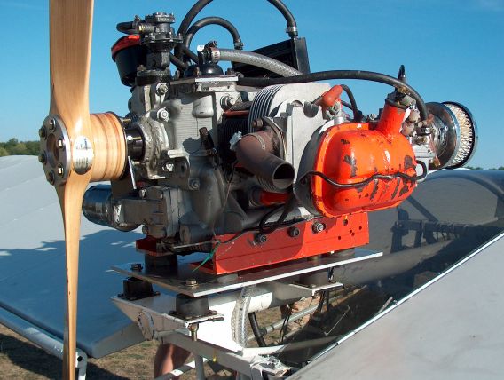

The attached photo is the 1/2 VW that was at the Kolb Homecoming 07. The
engine and installation was in a word rough looking but seemed to fly well
for what it was. I sure would like to see a redrive on one.
As for cooling I can't say on the 1/2 VW but my full VW runs a bit on the
cool side in the air. I do need to be careful on the ground. A guy called me
a few years ago looking to solve a over heating problem he was having with
his free air pusher VW. Turned out he was trying to break in the engine on
the ground like the Rotax guys do. I tried to convince the guy that it can't
be done without a large cooling blower something like they put on the car
engines. To this day the guy probably thinks there is something wrong with
his engine.
Starting my engine cold I can run it for 10-15 minutes at low power on the
ground before it starts to over heat. Once I start a fast taxi the temps
start to lower. In the air my CHTs never get over 300 degrees.
