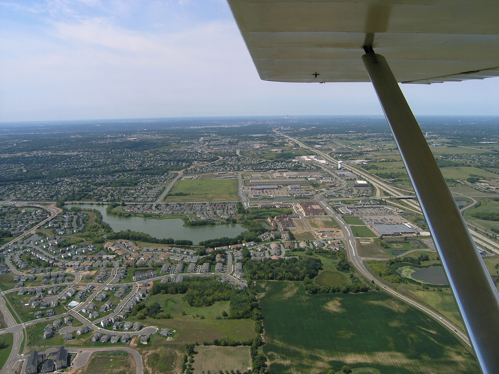

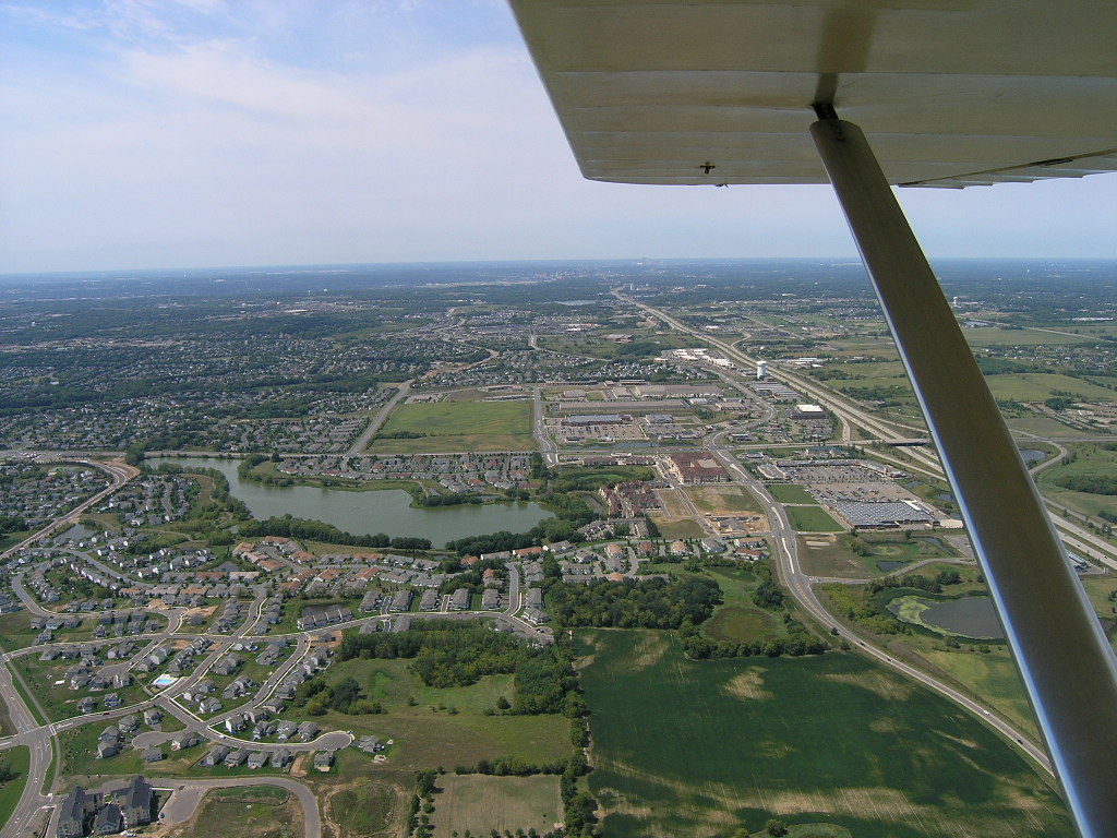

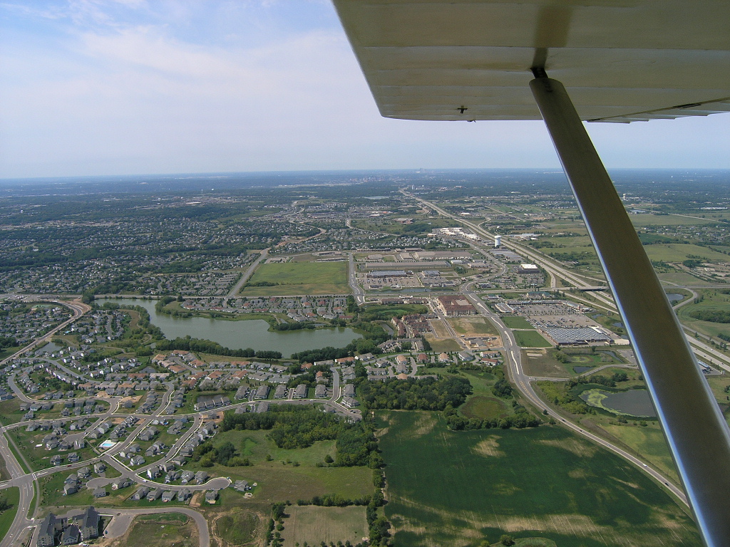

I replaced mine on my Original Firestar (that often gets mistaken for a Firefly). Mine are the kind with the tube inside and are all aluminum. I gained about 5 mph in cruise with them.
