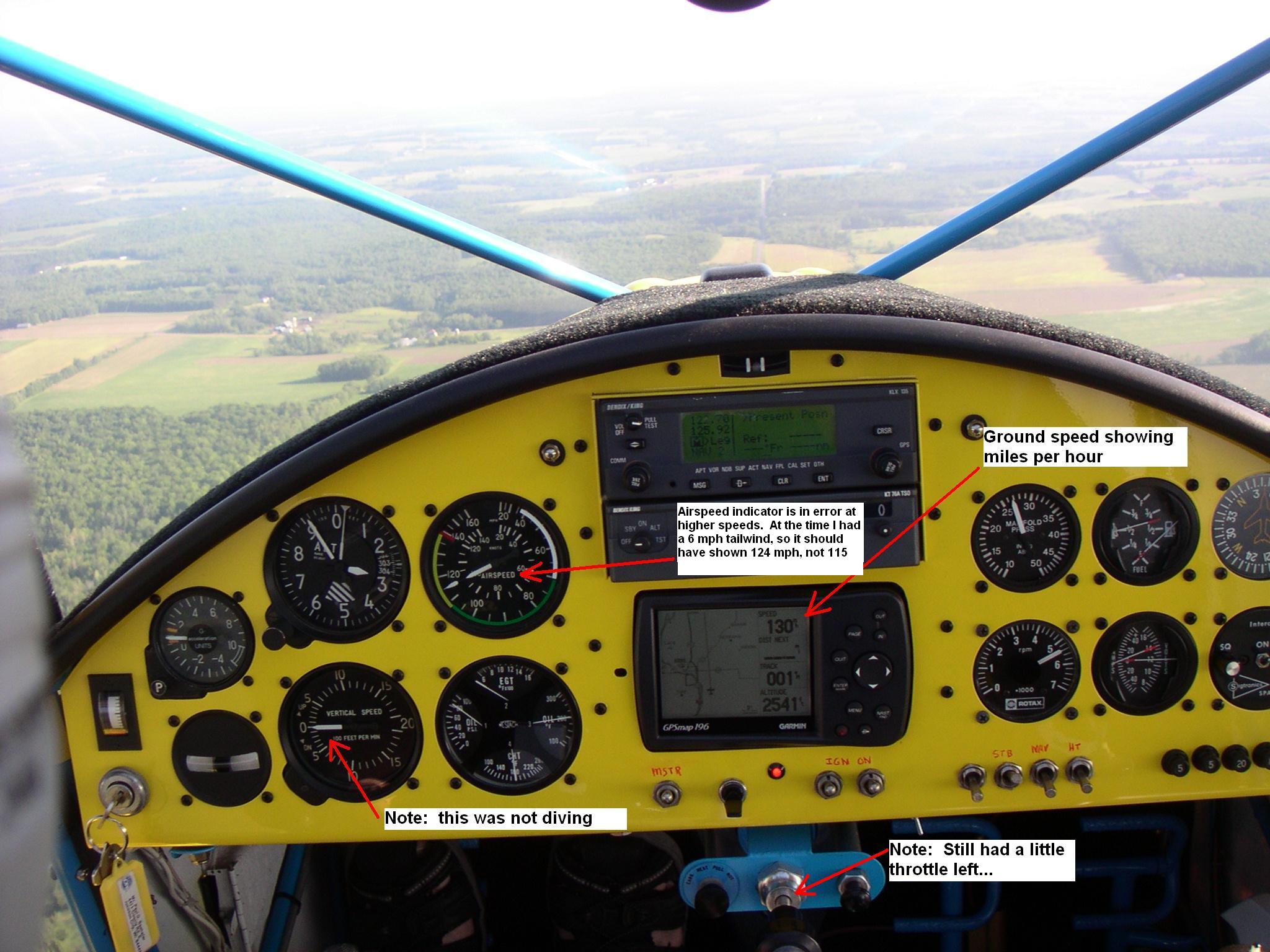

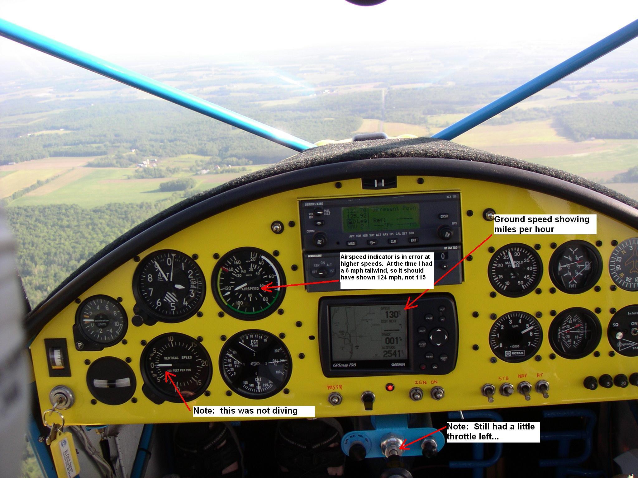

Lynn,
Yeah, you're right. I dont' buy that Smile But I want to say thanks for giving all of us a heads-up on the realities of owning and operating a Jabiru. Personally I hope they can continue to improve their support, as there is definitely a place for their engines in the light sport aircraft world. And frankly, I think it is a nice engine. There aren't a lot of jabiru owners yet, but of the ones I've heard from (like yourself) they are quite happy with their engines. That says a lot for a relatively new product. And as Iv'e said before, I like the simplicity of the Jab much more than all those hoses and such the 912 has.
One thing that has somewhat surprised me however about the Jab, is while the engine is advertised to be much lighter than the 912, empty weights aren't necessarily in agreement with that. As an example, my Model IV-1200 long wing was originally 627 pounds empty (currently closer to 650 due to add ons) with my 912ul, IVO inflight prop, electric engine heater, all plexiglass windshield, turtledeck and bubble doors, full panel, carpet, heater core type cabin heat with an electric fan, heavy 4 ply 8:00 X 6 aircraft tires, heavy paint, heavy plastic strut fairings for wings and horizontal stab, electric trim, wingtip strobes, landing and nav lights, dual brakes, 2 built in Gps's, solid baggage floor, electronic dual tank senders with sender covers glassed into top of wing tanks, etc, etc.
As I recall, your Jabiru 2200 model IV is a very similar weight? So how does it compare option wise? Comparing our similar model IV Kitfoxes is the best way to compare apples to apples for the group.
Paul Seehafer
Ps - here's a shot of my panel so you can compare it to yours for equipment

Paul-
Mine weighed 650 lbs at the weigh-in, and I've probably added another
20 with x-ponder, different radio, heat muffs, scat hose, etc. I'll
compare what my plane has and try to list what might be different. If
I skip an item, it means I have about the same thing.
Short wing, fixed-pitch prop, (no on-board engine heater), semi-full
panel, but mostly VFR, (no "weighty" heater other than heat muffs and
scat hose) wheel pants, same plastic strut fairings w/fabric and
paint, (no fairings on hort. stab), (no landing lights), one GPS,
baggage sack, (no electronic senders for fuel, just sight gauges). I
do have an airfoiled vertical stab and rudder, my own rib design and
rudder fairing...possibly heavy, and I have the 3-leaf tailwheel
spring, but with a Homebuilders Special (ACS) wheel. I just compared
my panel with yours, and they are nearly comparable. I have an EIS,
and you have more gauges, etc. I have the Grove gear.

Lynn,
This is interesting information. Looks like our Model IV kitfoxes are a lot the same, even though they vary by options. We each have things that are heavier than the others plane, but also have things that are lighter. So all in all it seems to pretty well balance out. Not scientific, but generally it goes to prove there isn't a substantial difference between the Jab and the Rotax by the time the airplane is done
I weighed my plane three times, twice on wheels, and once when when putting it on the floats. I only used electronic scales when doing the float W&B, but the numbers jived pretty well with what the other scales told us. So I believe my numbers are relatively accurate. My empty weight numbers also are pretty average when comparing to other 912 Model IV's, which run between 625 and 675 lbs typically.
I agree weighing engines as you described would be best. But really, average numbers for the various models will give the group here a good feel for what they can expect for average weights.
I've learned a long time ago that even though the specs say one thing, by the time you get the airplane done, it can be all different. A good example of that is my buddy that built an Avid Mark IV with a 618 rotax a few years back. After flying it a couple of years he replaced the 618 with a 912 ul, and his net empty weight gain was only 12 pounds. We all tried to figure out how that could be, but in the end gave up trying to figure out how that was possible. He's too busy flying the airplane now to worry about it. But it still mystifies all of us, including him.
I hope the group can further this study of various models with various engine weights. That could be really useful information for any of us.
Paul Seehafer
equipment
