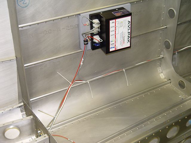

I am getting ready to attach the tailcone to the fuselage but I figure it would be better / easier to run all the wires for the items in the tail while I can still crawl into it before it’s attached. I was thinking about running conduit through the bulkheads down one side and pre running wires within it (or at least string).
Items for wiring
Nav Antenna
Tail Nav light
Tail Strobe light
Pitch Trim Servo wiring
ELT
Does anyone have any pictures of how they routed their wiring?
-Ben Westfall

I waited until after I attached the tailcone and found that I didn't need to crawl into the tailcone at all (yet). With the fuselage at the right height, everything is very accessible for my 6' bod and reach. Because all of the tailcone wiring runs forward, my thinking is that it's all easier to do with the fuselage joined. Then you have a good long session of wiring the battery compartment, tailcone, and other stuff.
My approach was to copy the routing used in Van's wiring kit (I didn't buy the kit). That is to run the wire down one of the J-stiffeners. Here's where thorough deburring pays off because you don't won't the wire to contact any burrs. For insurance, I put a 1 inch length of shrink tubing where it passes each bulkhead and then added a small length (3/8" perhaps) of edge grommet to each bulkhead. The grommet work really well without adhesive. It's all tied down with tie wraps. Very neat and easy. Giving the whole bundle a twist keeps everything especially neat. Which is not to say my installation is particularly neat... but I'll do better next time.
I ran wire for the nav light, strobe, pitch trim, and rudder trim (just in case I do the rudder trim later). I holding off on the ELT hoping there will be an experimentally priced solution with the latest tech standard (900mhz or whatever). I'm going with wing tip Nav antenna.
Generally, I'm avoiding conduit for all the initial wiring and only putting empty conduit in for any and all the stuff I'm bound to figure out later. Just a choice.
Attached is a pic but I'm not sure it will post. I can send directly.
Bill "done flying for a while and ready to build again" Watson

If you go this route, as I did, it would be much easier to drill and
deburr the holes in the J stiffeners now. It is easy enough to run the
wire later. I have a wire runs on each side.
Get the static port in now, also much easier than later.
At least that is how I would do it /next /time.
Larry

I did the wiring and static ports before attachment; it is easier to secure
the wiring, deburr the holes and install grommets or snap bushings. Another
means to secure the wiring is Adel clamps and click bond fasteners
http://www.clickbond.com/index.php. These can be epoxied anywhere and
provide a very secure wiring bundle to prevent chafing and repair down the
road.
