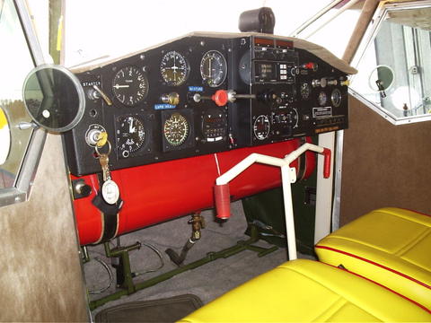

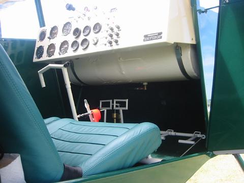

I can't remember the name of the fellow, from somewhere in the midwest,
who gave me this idea. Works great, just like a cessna Smile and comes
off with a single bolt. There is a self locking nut hidden in the tee.
I did weld a little extension at the root of the stick handle because
I didn't like the stick interference with the throttle at full up.
BB

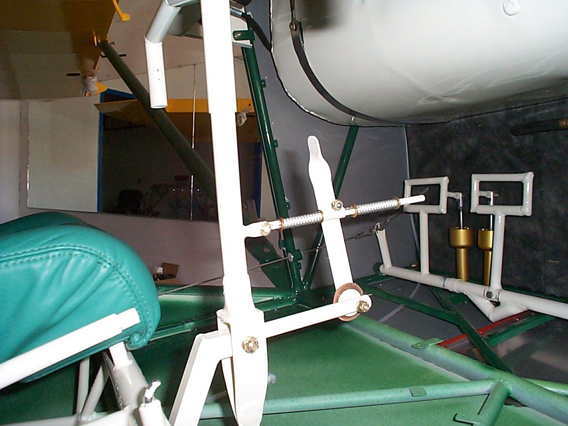

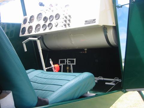

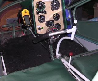

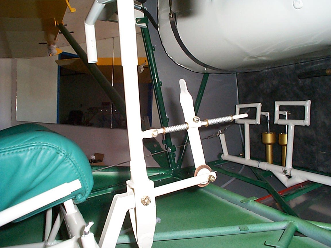

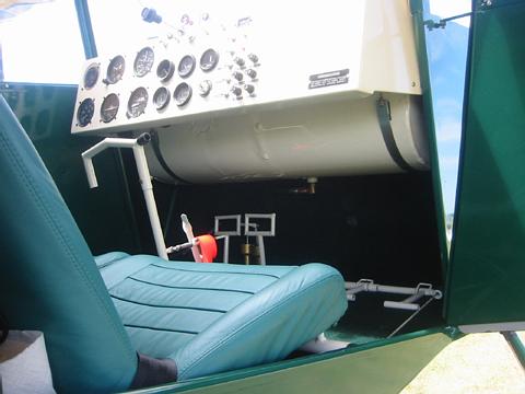

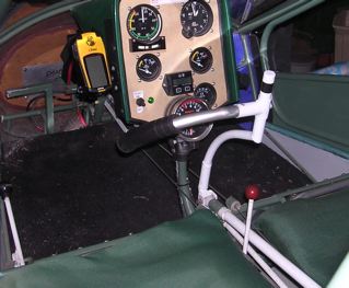

The Buttercup & Tailwind also use this stick in the middle...
The left side control is permanent and the right side will come off
with one bolt....They also do this from below , so the stick comes up
between yer legs... That style was in the Tailwind I got to fly.... But
I don't have pictures ( Right side came off with one bolt too )
Gotta Fly...
Mike & "Jaz" in MN
PS I threw in a picture of the SIMPLE trim system...

PostPosted: Mon Dec 31, 2007 8:06 am    Post subject: Single or Dual Controls Reply with quote
BB
Bob,
I shortened the throttle lever slightly to cure the stick interferance.
Denny
