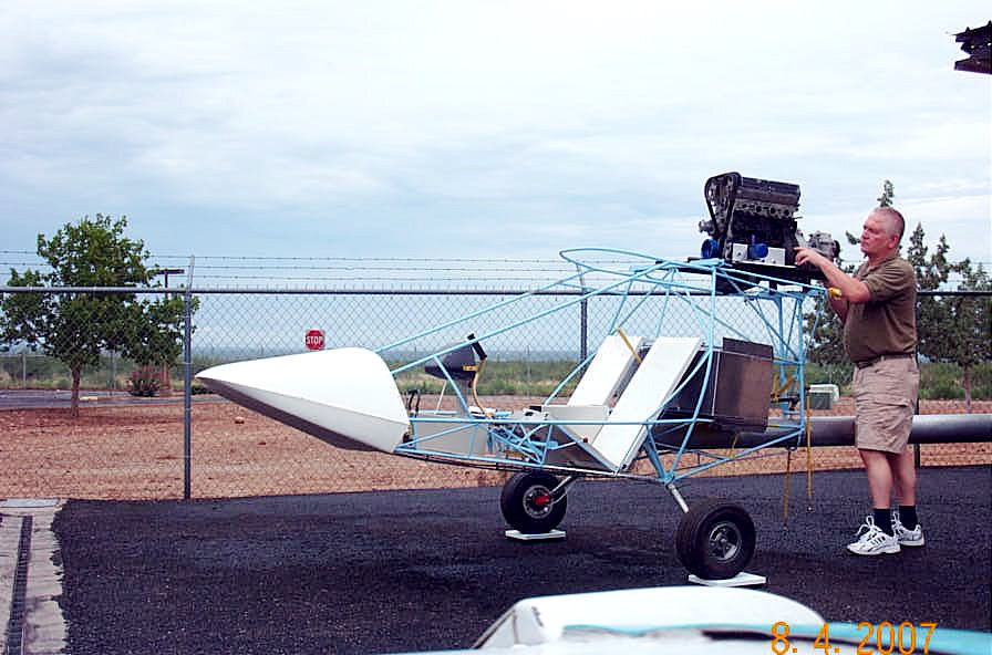

planecrazzzy Guest
Posted: Sun Dec 23, 2007 5:46 am Post subject: Re: per request some more pix of the M3X |
Hey Ron,
On the last picture ....I was looking at the "Nose cone"
Is it mounted at "THAT" angle ??????
Gotta Fly..
Mike & "Jaz" in MN
| Back to top |
captainron1(at)cox.net Guest
Posted: Sun Dec 23, 2007 10:25 am Post subject: per request some more pix of the M3X |
Hi Mike
I have gotten more than one question about it... laughing. The cone is held in place by friction alone. Right under the main gear in the pix there is the bathroom scales. I was weighing the frame and the motor for W&B in different positions. I was sliding it back and forth to get a rough read on the weights. The nose cone is not fastened at all, and in fact its now back occupying its dust outlined space in the hanger.
But you people are giving me an idea for a tilting nose under control as a form of a canard!!!!!! laughing. that dude is bottom flat enough to in fact provide lots of control authority, some winglets and some antennas on the sides will make it look like a cat fish swimming in water.
But that is on the back burner as well, till I finish it.
Ron
Arizona

mdnanwelch7(at)hotmail.co Guest
Posted: Sun Dec 23, 2007 11:54 am Post subject: per request some more pix of the M3X |
See, Ron, it wasn't just me that thought it looked a little odd. Mike, I already asked Ron about this, and he said it was just "hung" on, not mounted.

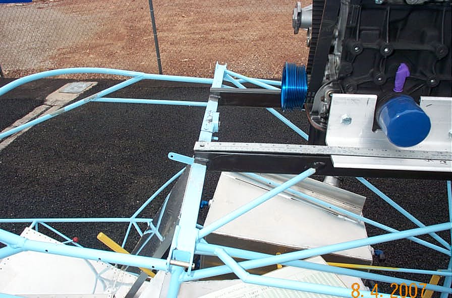

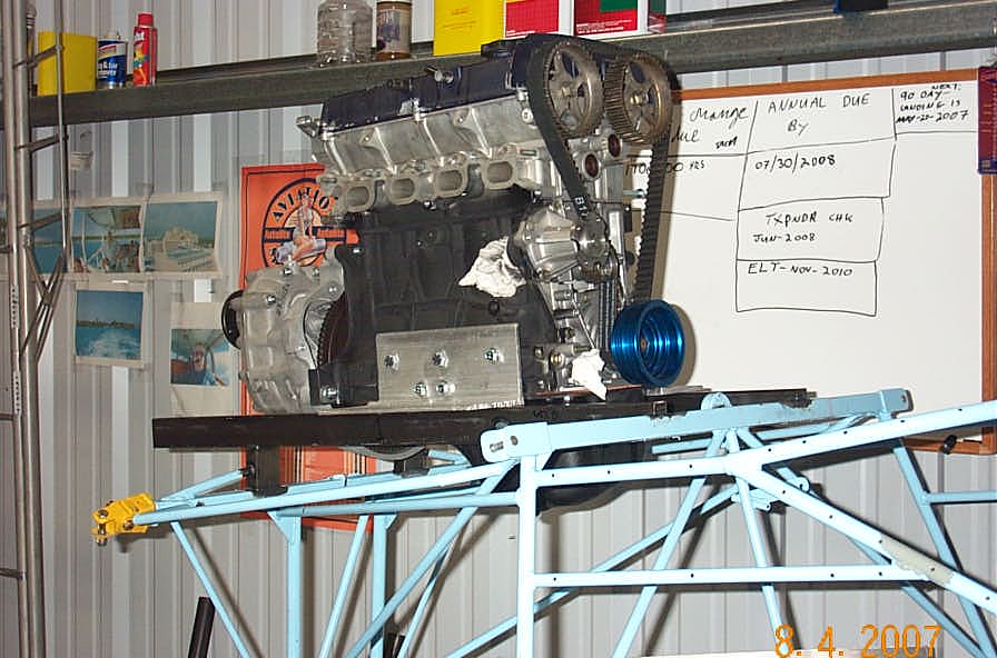

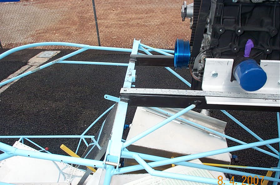

bill_joe(at)bellsouth.net Guest
Posted: Sun Dec 23, 2007 3:19 pm Post subject: per request some more pix of the M3X |
Ron .....it looks like you have changed the engine thrust line quite a
bit from the standard set-up . Do you think that will be a problem ?
Bill
| Back to top |
Posted: Sun Dec 23, 2007 4:56 pm Post subject: per request some more pix of the M3X |
I kept true to the original mount angle. The rear is lifted to about the same hight angle as the original single tube mount. The thrust line profile angle is the same. The motor may sit lower but that's because the mount cradles the motor and its not sitting as high as the factory mount. Which is good, taking the thrust line lower should reduce the pitch down force when applying power. But !!!! when fully installed it may sit identical to factory hight since the shock absorbers are about an inch thick and then the brackets on top of that are another .5 inches. We shall see.
