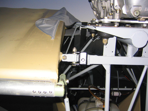

Hi Jim,
It just so happens I happen to have an extra English U joint if you want it.
I bought two for my Firestar II after I powder coated my cage and found out the wing incidence had changed. Turns out I only need one U joint to trim out the plane.
I powder coated them black because thats the color the powder coating guy was running at the time. You can lightly sand the coating and paint to match your airframe.
Let me know what you would like to do.
Best Regards
Carlos Grageda
grageda(at)innw.net
