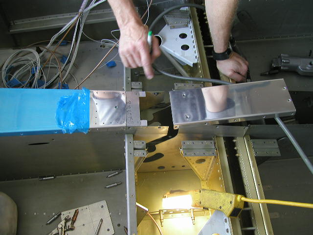

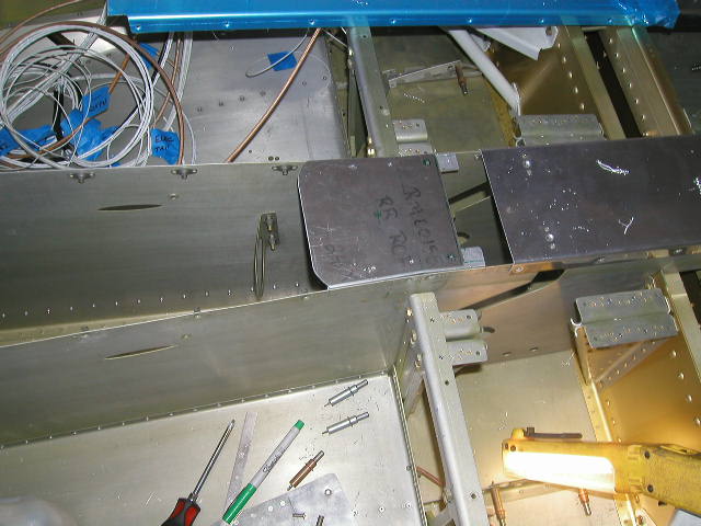

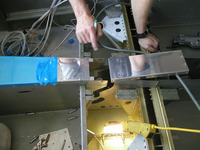

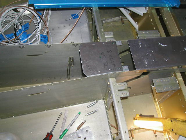

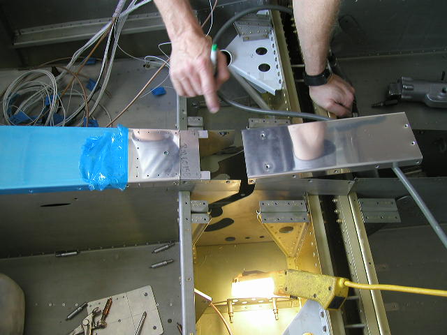

Here are the pictures of our Andair fuel selector mount; using Tim's
suggestion we left the tractor selector mount in place until our replacement
was fabricated and clecloed in place. Note that we have solved the problem
of removing the forward tunnel cover by splitting the aft end.
