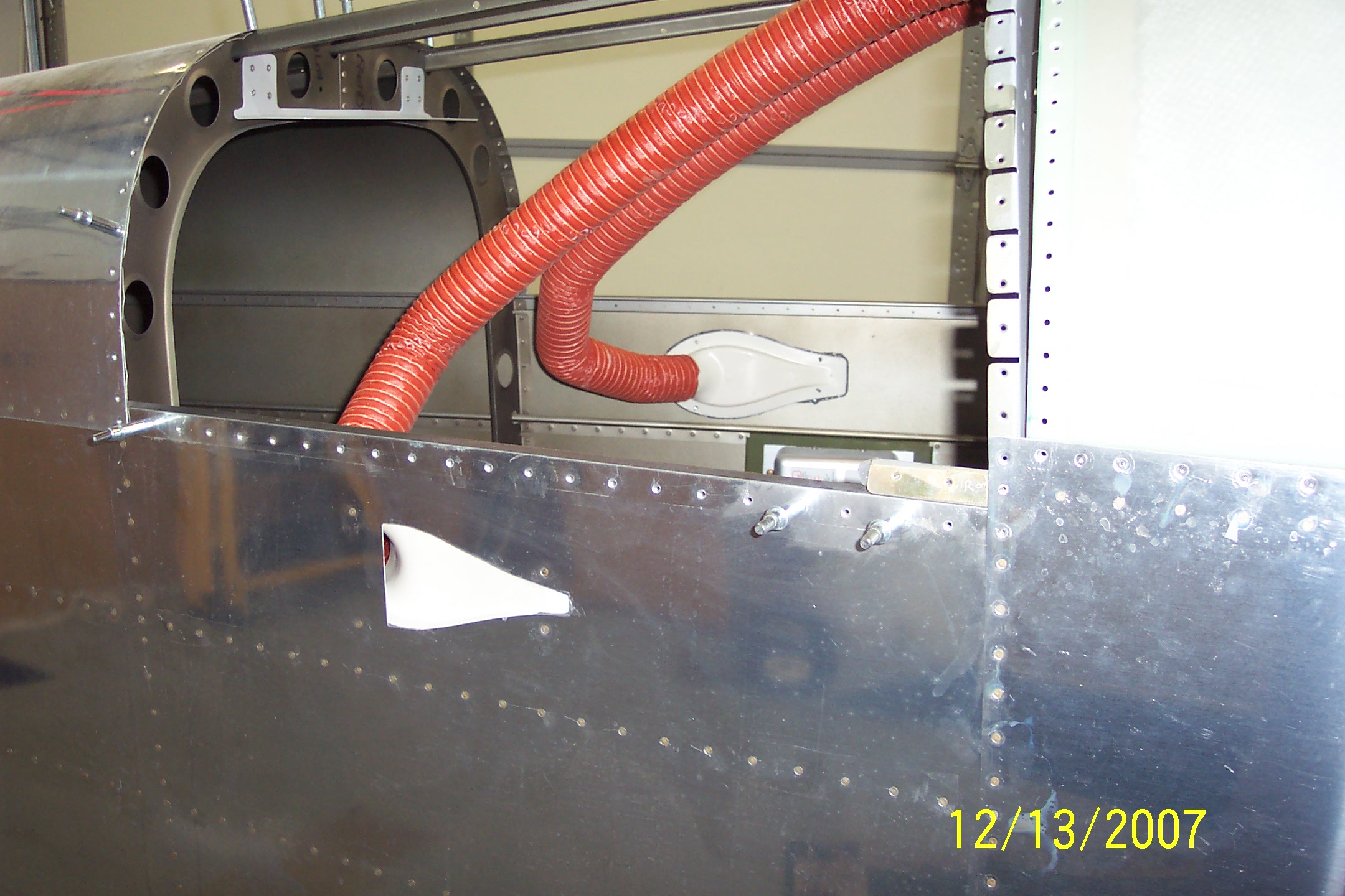

PostPosted: Thu Dec 13, 2007 6:39 am    Post subject: NACA Vents Reply with quote
Bob:
I bought the ones from Vans'. Order them when you need something else. I
waited until I had the top on to cut the holes. Made up a template of
the NACA hole before I installed the forward vents. Then just traced it
on the skin and used a nibbler to remove the majority of the aluminum.
File to do the rest. I placed the front of the vent 10 inches behind the
rivet line of the bulkhead, centered in between the longerons. No
science involved. On accuracy's web site there is a reference to them
working well. You can wait until later to install them as the top skin
will be off until you are ready.
I have more pics if you need them.
Fred Williams
day job getting in the way of building.

PostPosted: Thu Dec 13, 2007 7:47 am    Post subject: NACA Vents Reply with quote
Thanks for the quick response. The picture was very helpful.
I'm assuming that the tray attached to the bulkhead is for your ahrs?
Out of curiosity, what's installed below the naca vent on the left side?

drfred(at)suddenlinkmail.
PostPosted: Thu Dec 13, 2007 8:24 am    Post subject: NACA Vents Reply with quote
Bob:
It's the power supply for the strobes. Whelen (sp?) . Vans has a
plate that will let you attach it to the stringers.

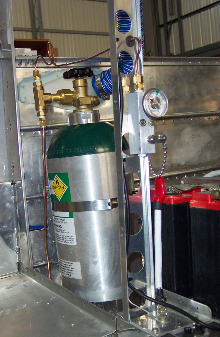

PostPosted: Thu Dec 13, 2007 1:03 pm    Post subject: NACA Vents Reply with quote
Bob,
I am on the road so this is the only photo I have available. We placed ours just behind the baggage bulkhead. Again no science, just the shortest distance and it's the same place one of the very first OH console installers placed his with good results.
We waited till late in the build to add the vents but well before the canopy was attached. Wait... The canopy still isn't attached. Darn.
If you want to see some detail of our OH console visit: http://www.painttheweb.com/rv-10/console.htm
