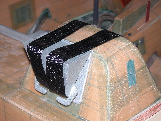

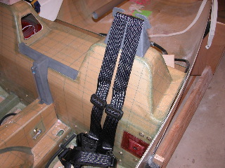

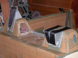

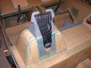

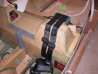

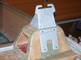

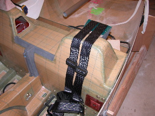

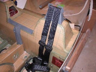

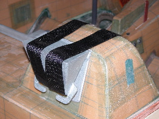

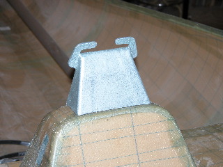

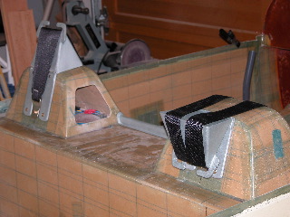

Hi guys,
Just wanted to share a solution to the issue of raising the shoulder
harness restraint sufficiently to minimize the potential for spinal
compression during a rapid deceleration event.
This approach allows for one to sit upon the existing head rest while
entering and exiting the aircraft, does not encroach upon the access to
the baggage area, confines all forces to the CM rather than
transferring them to the fuselage shell, and can easily be added to a
completed and upholstered cockpit.
Although the riser weighs but 10 oz., it is robust enough to withstand
the compression load generated by a 1500# tension load on the straps
measured at an angle of 90 degrees to the slope of the back of the
headrest; testing was done using a 20 ton hydraulic press. Assuming an
upper body wgt. of 100#, it would be good for 15 Gs.
Comments appreciated!
Fred
A194
PS: If anyone wants to duplicate this as a nice little winter project,
I could be persuaded to put together some kits of the hot-wired foam,
hinges, acft. plywood, and instructions...contact me off-list.

PostPosted: Mon Dec 03, 2007 12:59 pm    Post subject: Shoulder harness restraint Reply with quote
Fred,
Ingenious with respect to structure and "hinging out of the way", but:
Do you see a risk in the harnesses cutting into each side of your neck when
under significant tension, since the two harness parts are restrained in the
center just behind the neck? The normal spread angle between the two parts
(supposedly comfortably snug on each side of the neck during normal flight)
will tend to narrow under tension, will it not?
Best regards,
Svein
LN-SKJ

fklein(at)orcasonline.com
PostPosted: Mon Dec 03, 2007 3:24 pm    Post subject: Shoulder harness restraint Reply with quote
<ptag.dev(at)tiscali.co.uk>
If you have the original belts are they long enough or do you need
longer ones?
Bob Harrison. G-PTAG
Bob,
The original belts are more than adequate for me (6'-1" and 195#). I'd
wondered about that very thing but after trial fitting the side mounts
for the seat belt, climbing aboard, buckling up, and making suitable
airplane noises, everything was aok.
Fred
A194
believed to be clean.
PostPosted: Mon Dec 03, 2007 3:39 pm    Post subject: Shoulder harness restraint Reply with quote
when under significant tension, since the two harness parts are
restrained in the center just behind the neck?
Svein
LN-SKJ
Svein,
Not really...if you consider the rear attach point where the 2 shoulder
straps begin and the points where they attach to the seat belt in
front, you will trace straight lines which diverge from one's neck
rather than "scissoring" it under tension.
Thanks for your comment,
Fred

I really didn't want to re-invent the wheel here, so one of the
starting points was to not alter the attach point of the shoulder
straps...and to secure the "riser" to the same hard point used for the
straps. If our shoulder straps had had individual bolts to the hard
point(s), I would have maintained them; since they go back to a single
point, that's what this design works from. The key to
"minimise...chafing of wearer's neck" is the location of where the
shoulder straps connect to the seat belt; in my opinion, there is no
cause for concern here.

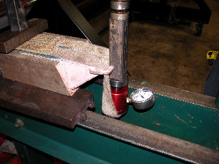

Was your load testing applied to the straps as fitted to the device in
the aircraft or merely to the device sat on a strong surface?

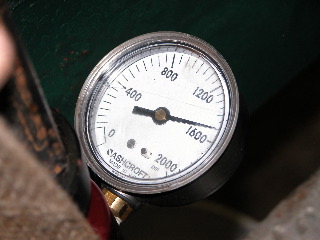

I've done no testing with this "riser" bolted to the CM. The photo
below shows the test rig I used. The riser is mounted on a piece of 4 x
10 wood with an angled face, set to duplicate the angle between the
back and top of the head rest. Unseen beneath the strapping are two AN3
bolts which correspond to those bolts which penetrate the hard point on
the back of the headrest and flank the AN4 bolt which secures the
typical shoulder straps; see other photos. Note that I've substituted
2" wide cargo straps for the standard issue shoulder harness straps;
since I'm testing this little "riser" and not the shoulder harness, I
thought this would have no effect. Note also that the straps are
clamped beyond the edge of the "flap"; the riser is held in place
solely by the two AN3 bolts (under the straps).

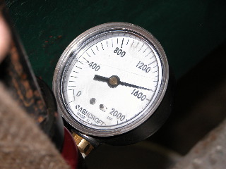

Also visable in the photo is a gauge resting on a loop in the straps
with a pressure plate beneath a 2 x 2 steel tube which receives the
force from a 20 ton hydraulic press.
The test rig presumes that tension forces on the shoulder straps will
be transmitted to the "riser" at its apex which has a radius of
3/8"...so the big question was...Would the "riser" be crushed? Well, I
really didn't want to destroy it, so I stopped at 1500#; this load was
reached incrementally...it was not an instantaneous load.

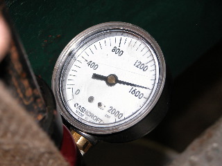

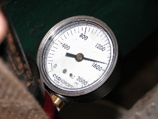

Full Disclosure: My buddy with the hydraulic press uses this gauge to
measure the tongue weight on trailers he uses w/ his business...he
swears that it measures weight in pounds. However, as you can see in
the next photo, the gauge is labeled in psi. You can note the size of
the pressure plate in relation to the 2 x 2 steel tube...it appears to
be about 2.5 inches in diameter...which means its area is just under
4.9 sq. in. This then implies (to this non-engineer) that the force on
the straps would be more like 7359# rather than just 1500#. Could this
be so? Help!
And would it be better to wrap the forward edge of the device around
the front edge of the headrest, to reduce the eccentricity of loading
on that corner? thereby maximising the resistant of the front face of
the headrest
Though it appears greater in the photos, the front face of the riser
is only about 1/4" back from the face of the head rest...the
intersection between the top and the front faces of the head rest has a
radius...I sized the "riser" so as to not extend beyond the start of
the radius. Personally, I'm unclear as to what portions of the loads
are transmitted to the front face and what portions are distributed
over the top head rest surface. The head rest construction appears to
me to be the same on all faces, so I didn't think aligning the front
faces would be significant.

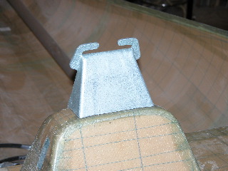

Would prefer to see the guides at the top made as part of (or recessed
in to) the moulding, with broad rounded edges.
The beauty of homebuilt aircraft is the latitude (at least here in the
US) it gives to allow for personal preferences. The design I developed
was intended to both satisfy the functional requirement and be
sympathetic to the tapered forms of the head rests...guess I could live
with the "ears"!
Ron Pagoris has suggested I do some load tests of side loads such as
those which might be encountered in a ground loop...so notwithstanding
the pixs of these puppies on my CM, I guess it's back to the lab for a
bit.

Thanks for your input and questions...answers indented below.
-> Europa-List message posted by: "Duncan & Ami McFadyean" <ami(at)mcfadyean.freeserve.co.uk>
Fred,
Nice execution of a good idea.
CSA-VLA provides little guidance:
http://www.easa.eu.int/doc/Agency_Mesures/Certification_Spec/decision_ED_2003_18_RM.pdf
See pdf page 100 (or pages 2-8 and 2-9 at the back.
It merely advises for "..adequate separation of ...straps to minimise... chafing of wearer's neck...." but recommends a maximum separation of 8" and maximum included angle of 60 degrees.
I really didn't want to re-invent the wheel here, so one of the starting points was to not alter the attach point of the shoulder straps...and to secure the "riser" to the same hard point used for the straps. If our shoulder straps had had individual bolts to the hard point(s), I would have maintained them; since they go back to a single point, that's what this design works from. The key to "minimise...chafing of wearer's neck" is the location of where the shoulder straps connect to the seat belt; in my opinion, there is no cause for concern here.
Was your load testing applied to the straps as fitted to the device in the aircraft or merely to the device sat on a strong surface?
I've done no testing with this "riser" bolted to the CM. The photo below shows the test rig I used. The riser is mounted on a piece of 4 x 10 wood with an angled face, set to duplicate the angle between the back and top of the head rest. Unseen beneath the strapping are two AN3 bolts which correspond to those bolts which penetrate the hard point on the back of the headrest and flank the AN4 bolt which secures the typical shoulder straps; see other photos. Note that I've substituted 2" wide cargo straps for the standard issue shoulder harness straps; since I'm testing this little "riser" and not the shoulder harness, I thought this would have no effect. Note also that the straps are clamped beyond the edge of the "flap"; the riser is held in place solely by the two AN3 bolts (under the straps).
Also visable in the photo is a gauge resting on a loop in the straps with a pressure plate beneath a 2 x 2 steel tube which receives the force from a 20 ton hydraulic press.
  The test rig presumes that tension forces on the shoulder straps will be transmitted to the "riser" at its apex which has a radius of 3/8"...so the big question was...Would the "riser" be crushed? Well, I really didn't want to destroy it, so I stopped at 1500#; this load was reached incrementally...it was not an instantaneous load.
  Full Disclosure: My buddy with the hydraulic press uses this gauge to measure the tongue weight on trailers he uses w/ his business...he swears that it measures weight in pounds. However, as you can see in the next photo, the gauge is labeled in psi. You can note the size of the pressure plate in relation to the 2 x 2 steel tube...it appears to be about 2.5 inches in diameter...which means its area is just under 4.9 sq. in. This then implies (to this non-engineer) that the force on the straps would be more like 7359# rather than just 1500#. Could this be so? Help!
And would it be better to wrap the forward edge of the device around the front edge of the headrest, to reduce the eccentricity of loading on that corner? thereby maximising the resistant of the front face of the headrest
Though it appears greater in the photos, the front face of the riser is only about 1/4" back from the face of the head rest...the intersection between the top and the front faces of the head rest has a radius...I sized the "riser" so as to not extend beyond the start of the radius. Personally, I'm unclear as to what portions of the loads are transmitted to the front face and what portions are distributed over the top head rest surface. The head rest construction appears to me to be the same on all faces, so I didn't think aligning the front faces would be significant.
Would prefer to see the guides at the top made as part of (or recessed in to) the moulding, with broad rounded edges.
The beauty of homebuilt aircraft is the latitude (at least here in the US) it gives to allow for personal preferences. The design I developed was intended to both satisfy the functional requirement and be sympathetic to the tapered forms of the head rests...guess I could live with the "ears"!
  Ron Pagoris has suggested I do some load tests of side loads such as those which might be encountered in a ground loop...so notwithstanding the pixs of these puppies on my CM, I guess it's back to the lab for a bit.
Fred
