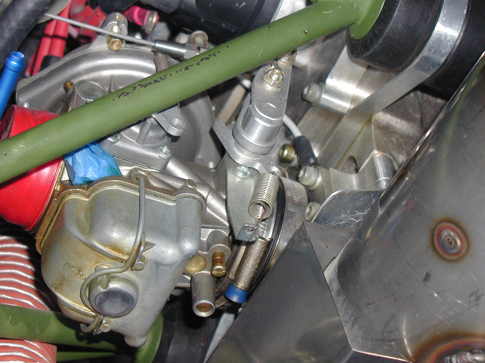

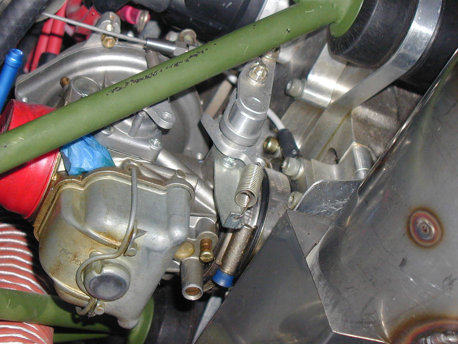

I'm concerned that the method I use to secure the throttle cable to the carburetor on my Jab 2200 is not sufficient or safe. Need some opinions before I redesign the connection. The throttle cable is connected to an ACS wire grip, PN 05-16000 which is then connected to the carburetor lever. The systems worked well but I'm concerned the wire grip may let loose at bad time. Any advice will be appreciated

On my installation I used an internally threaded aluminum rod of
about 3/16" diameter and about 1/2" long, as the connection to the
carb arm/lever. I did NOT use the questionable stuff that came with
the engine. I used an Aircraft Spruce vernier throttle control which
uses a solid wire as the actual link to the carb lever. What the
3/16" threaded rod does is goes through the carb lever, and allows
the throttle control wire to pass through it...crossways. The
internal threads are 8-32, as I recall, threaded all the way through
the 1/2" long aluminum rod. I then used 8-32 set screws from both
sides of the rod, and this grips the throttle control wire. I don't
have any pictures of this at this time...sorry.
I hope I've explained it well enough. It's a pretty simple, but
effective way of gripping the control wire, and pivots within the
carb lever as it should. If adjustments are necessary, loosening one
or both of the set screws will allow for that.

Thanks for the information guys. Since Jay has been successful with the wire grip, I may not change mine. Lynn, how is the internally threaded rod attached to the carb lever. I can't picture it from your comments. More on my set up, I have a ACS vernier throttle which is connected to ACS wire grip in question, the wire grip is then connected to a rod end which is connected to the carb lever. I might add, the carb lever is special design and built by Dave Jalanti. His design add more throw to carb lever which gives more travel to the vernier throttle thus finer adjustments. Heres some photos of my set up.

I also have the Dave Jalanti-designed lever/arm. I'm going to the
hangar in about an hour and I'll shoot some pictures of mine...I
already have the cowl off. As I recall building it, the internally-
threaded rod has a head (forgot to mention that last night) and it
slides through the Jalanti arm, with the throttle wire going through
the cross hole securing the rod from going back through the arm. Then
the set screws secure the wire to the rod.
I'll get some pics.

| Quote: |

Your installation looks very good, Dan. It sure looks more rugged
than mine. However, I've got over 400 hours on mine and it hasn't
given up yet. I tried to find that "grip" device in the Spruce
catalog, but no such luck.

That item seems like a nice way to terminate a control wire.

I just did the search. It is called wire grip and is located in
page 149 of the ACS catalog.
José

AirCraft Spruce. They sell many parts with the ACS brand. Two of those are the ignition switch and the gascolator.
I found the wire grip searching on their website. The pdf I got shows page 149.
I also have the adapter from Dave Jalanti, and have been thinking about doing exactly what you did. However, the wire grip looks elegant...
Jose

My NSI Subaru uses two of these wire grips, one for the carb heat, and one
for the mixture control. They seem to work very well, but you need to keep
an eye on them. One thing they do when gripping the wire is they put a
bunch of little cuts into it from the gripping jaws. One day when I pulled
the carb heat knob it came all the way out, not stopping at the usual 3
inches. When I later inspected the wire I found that it broke off right at
the point where the gripping cuts were. I use good quality Boden Cables
too. Not a real big deal for carb heat.
However, the other wire grip on the mixture control is the one that bothers
me. If it broke, my mixture would go to full lean which will allow the
engine to run at cruise rpm and lower, but not at climb power, the worst
place. If it broke at this point, it could be a real problem. I solved
that by adding a spring to the mixture arm that, if the cable were to break,
the arm would go to full rich.
My suggestion is that if you use them, don't put one on the throttle cable.
Not a good place for something that needs to be nearly 100 percent reliable.
There is a better connector for the throttle control and I'll try to find it
and post to the list.
Deke Morisse
S5/Subaru
NE Michigan

My suggestion is that if you use them (wire grip), don't put one on the throttle cable.
