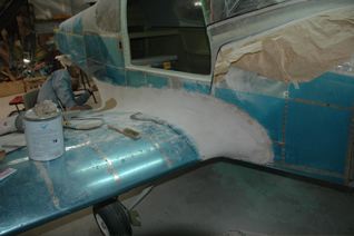

We are in the process of making a wing root fairing (fillet) that will
reach aft beyond the step. We should be doing testing in the next 2
weeks. I will post the results if there is an improvement.
Jesse Saint

This is a preliminary look at them. We have the molds made and will be pulling our first parts off this week, probably. No promises, but we will test carefully and thoroughly for improved performance.
Jesse Saint
Saint Aviation, Inc.
Cell: 352-427-0285
Fax: 815-377-3694
