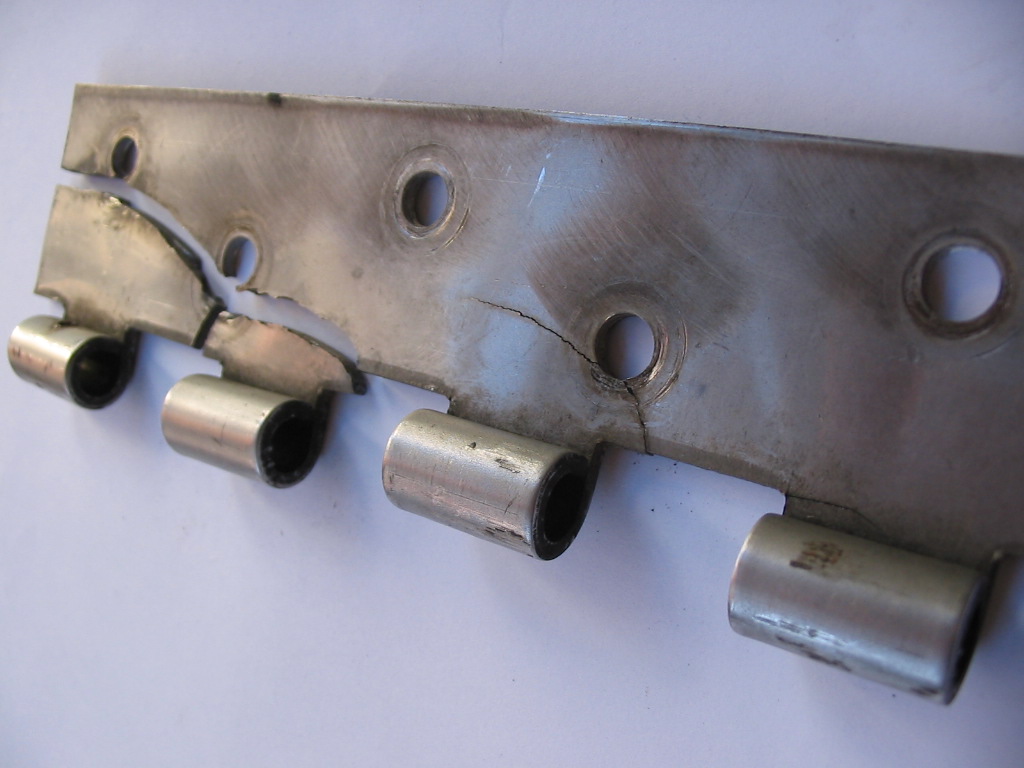

Further to my recent e-mail regarding the condition of the lower flange of the hinge on my mono trailer I attach herewith a photograph of the flange.
Owing to the proximity of the hinge to the ground it can only been seen using an inspection mirror.

I would suggest that is "stress corrosion" of the stainless hinge.
Caused by road salt and wrong choice of alloy. (I used to work for a
company that made stainless steel)
