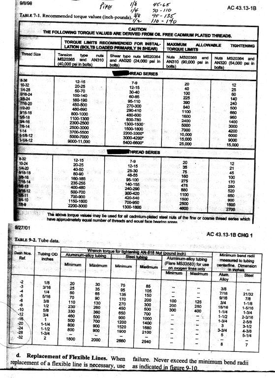

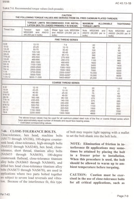

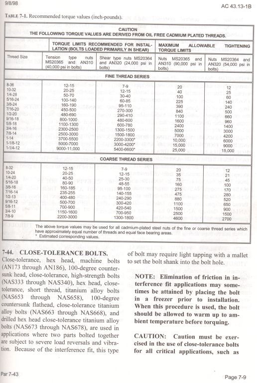

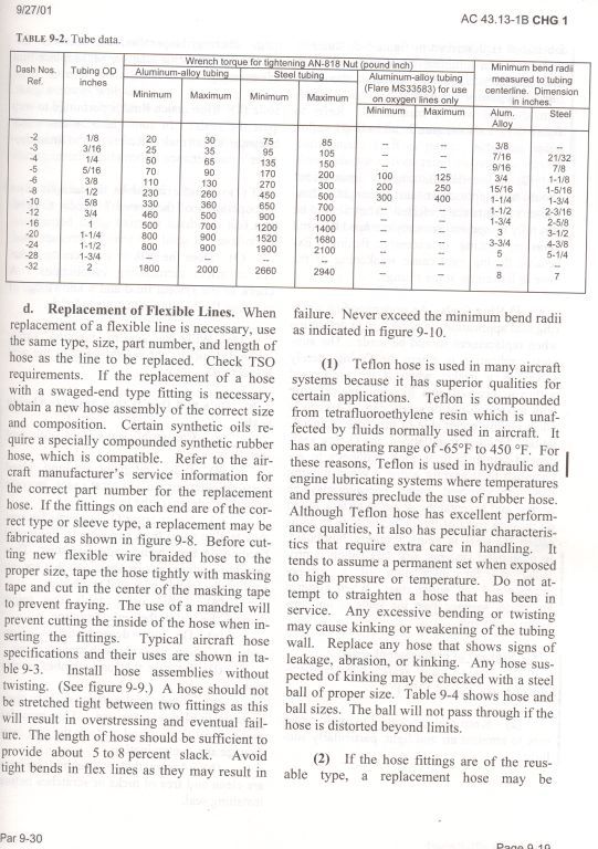

Bill Schlatterer
Posts: 195
PostPosted: Fri Nov 30, 2007 5:48 pm    Post subject: bolt/nut torques Reply with quote
Bill, maybe these will help. Note pipe and AN values.
Bill S
