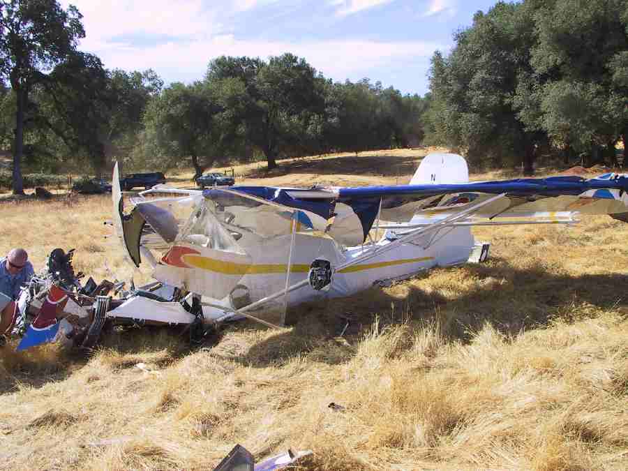

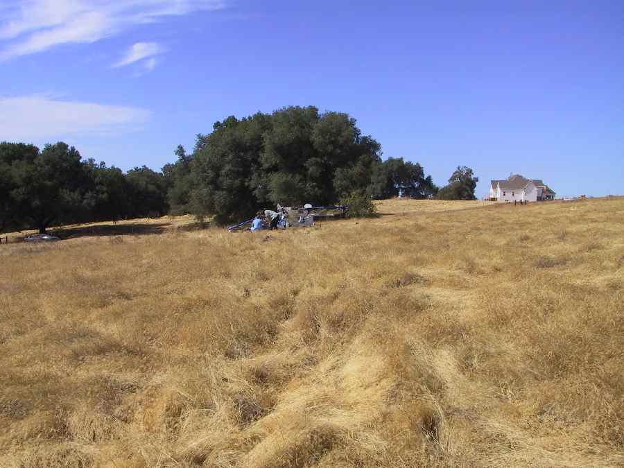

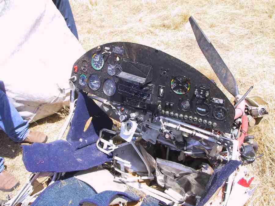

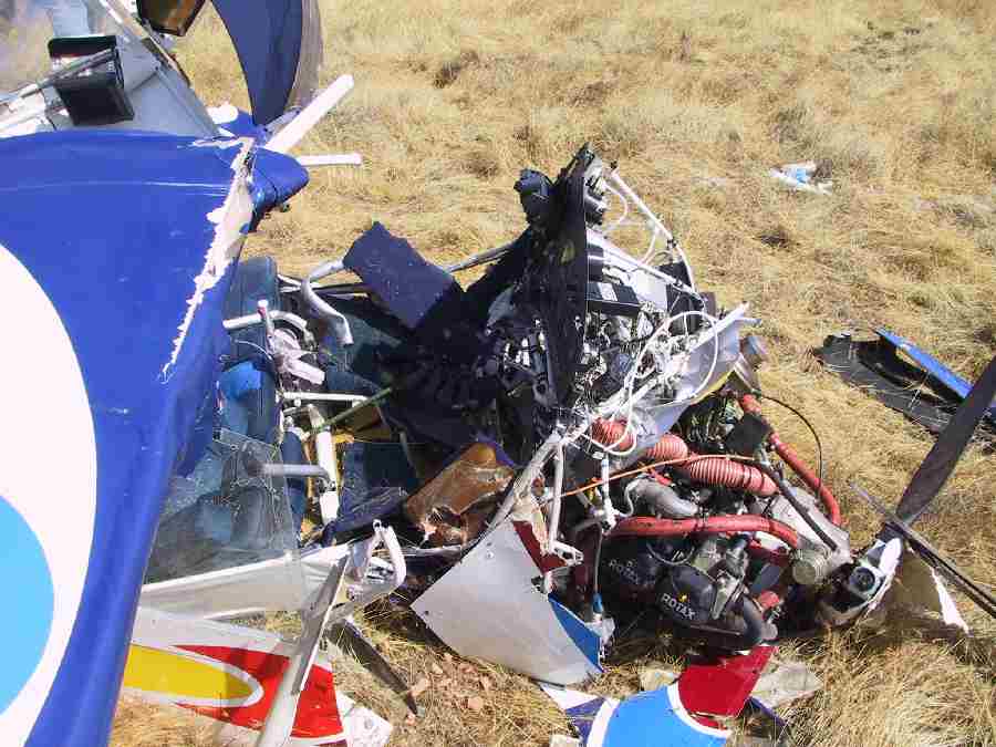

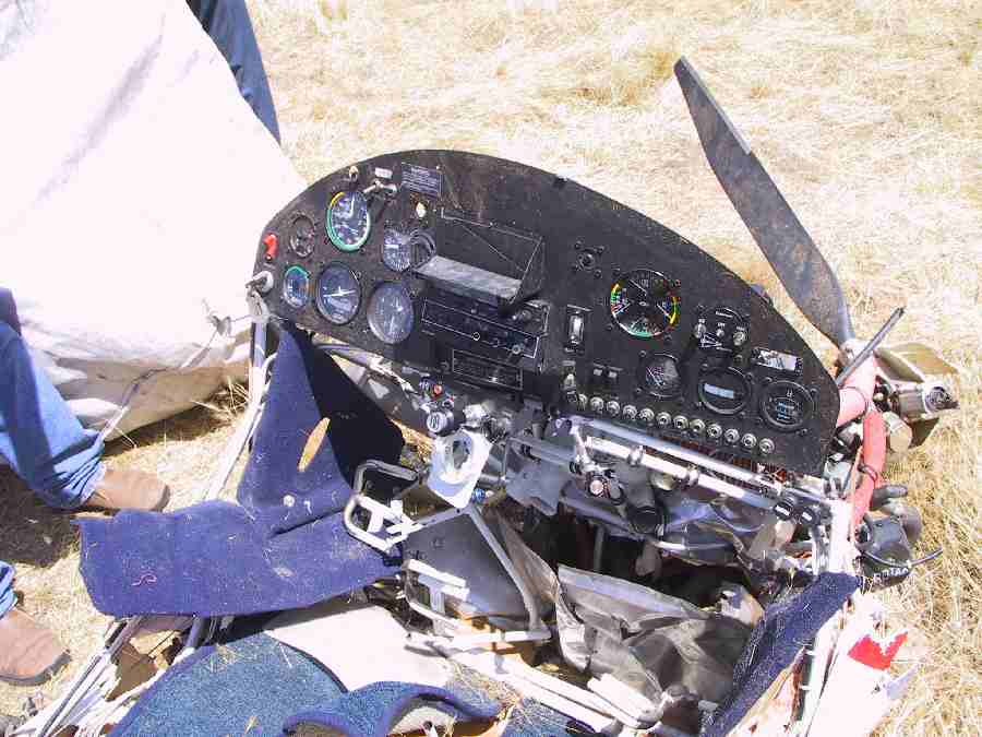

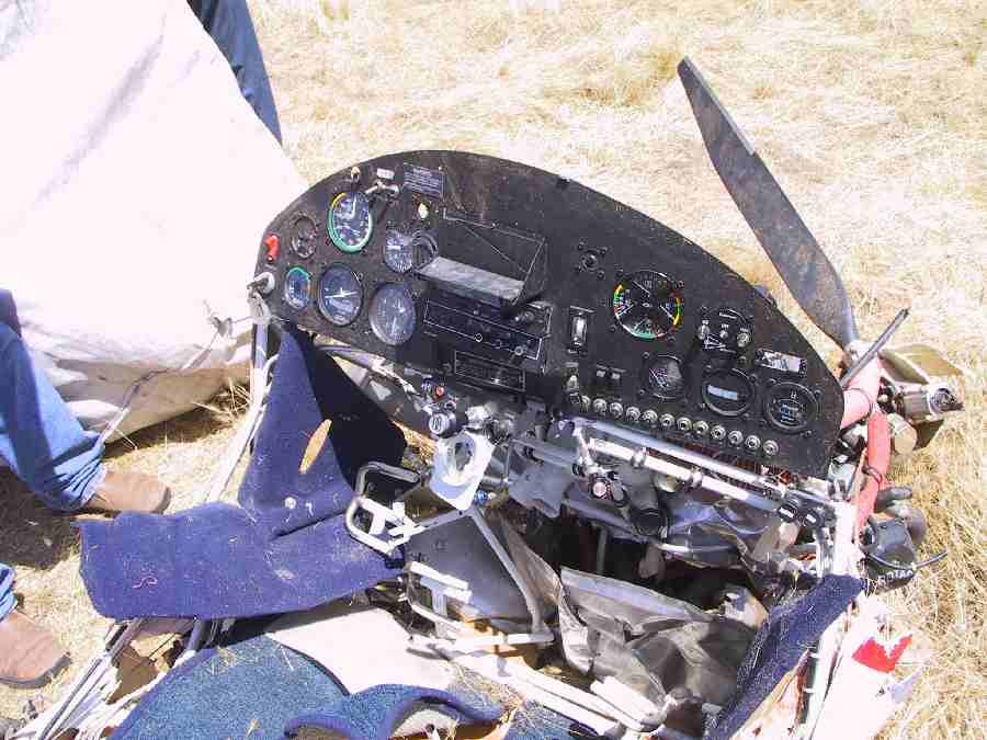

Based on my observations after viewing my destroyed airframe at the boneyard
and a close look at some pictures taken at the crash site by a friend, I
would conclude that the tig welded joints on my Model IV airframe were not
normalized after welding. There were very few welds that broke if any.
Every broken joint was within 2" from the weld. Exactly where the
crystalization would be expected. What this means in everyday flying, I
won't hazard a guess except to say that historically, there has never been
an airframe inflight failure. Hard landings? Another matter entirely.
I am attaching some photos of the airplane. They have been reduced in
resolution for band width reasons and the resolution is not great.
