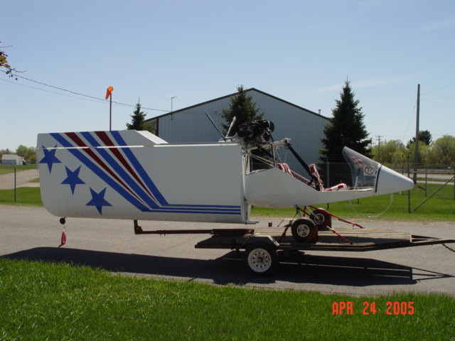

Hey Grant,
Get a boom support fer yer Tail....
You might have Lucked out because the tail had the least amout of
bouncing with the tail at the hitch....
The Hole in the fabric.....Take a picture when you ask about stuff like that
....it could be as simple as tape....a picture might also stir up other questions...

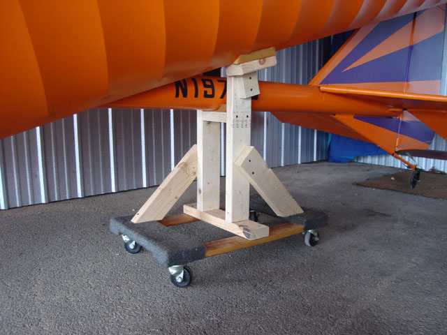

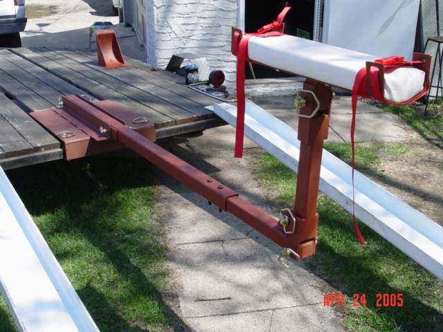

PostPosted: Wed Nov 28, 2007 8:44 am    Post subject: Re: HAULING mk III without boom stand? Reply with quote
grantr wrote:
Are there any plans for a simple boom stand?
I don't know about plans, but I may try to copy this guy's boom stand (picture attached). But looks like it's just for storing, not traveling.
 Filesize:  98.5 KB
 Viewed:  475 Time(s)

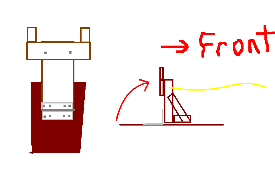

PostPosted: Wed Nov 28, 2007 10:29 am    Post subject: Re: HAULING mk III without boom stand? Reply with quote

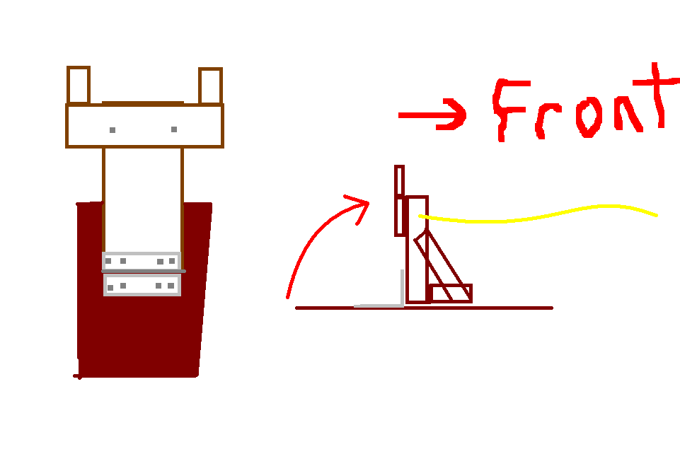

Dana,
Please do post more pics of it.
I have an idea in mind.
I am thinking of using a 2X6 and some heavy duty hinges to make a swing up boom stand.
I attached a sketch . the gray is the hinge. yellow is the rope.
front being from of the trailer.
What do you guys think of this?
 Filesize:  1.79 MB
 Viewed:  524 Time(s)

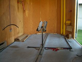

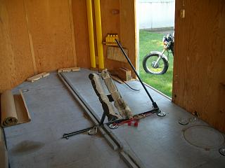

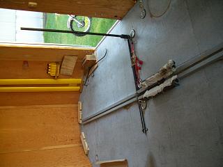

gaman(at)att.net

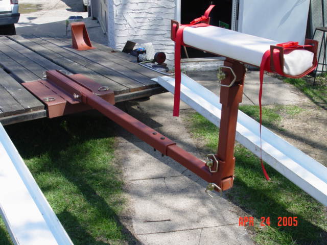

PostPosted: Wed Nov 28, 2007 3:53 pm    Post subject: HAULING mk III without boom stand? Reply with quote
I would like to try to post some picts of my boom support.I hope I do this right.If not,sorry in advance.
G.Aman
grantr <grant_richardson25(at)yahoo.com> wrote:[quote] --> Kolb-List message posted by: "grantr"
Dana,
http://forums.matronics.com/viewtopic.php?p=149147#149147
 Filesize:  12.96 KB
 Viewed:  438 Time(s)
 Filesize:  12.47 KB
 Viewed:  474 Time(s)
 Filesize:  12.32 KB
 Viewed:  480 Time(s)
agustafson(at)chartermi.n
PostPosted: Wed Nov 28, 2007 4:13 pm    Post subject: HAULING mk III without boom stand? Reply with quote
I like Gary's even better than mine!!!
Aaron
