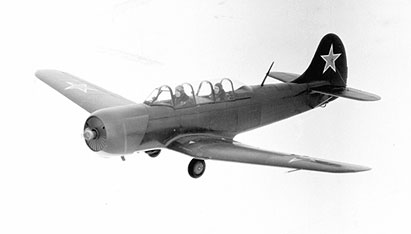

PostPosted: Tue Nov 27, 2007 9:33 pm    Post subject: Car Gas/turbins Reply with quote
. In 2001 when Bushi was asked by one of the AZ guys about that, he told them it would be better to design a whole new airplane. Still - - - - -
Jim "Pappy" Goolsby
Hmmm….Design a whole new airplane….novel idea! [img]cid:image001.jpg(at)01C8314D.A9B78A80[/img]
:>0 ;>))
Doc

PostPosted: Wed Nov 28, 2007 6:07 am    Post subject: Car Gas/turbins Reply with quote
Yep,
You see before you a real life Yak 18A.
But its all fabric covered!
And it has a steel tube frame.
Look! all the stabilizers are externally braced and covered with fabric
And that airfoil - - why its the old Clark Y!
And there is that landing gear, stuck out in the breeze. Will keep you from going passed Vne to quickly. That's good. And, Yep its great for the gear up landings these guys are so good at! Wink
Geee the engine is only 260 hp (Must be pretty doggy). How come the CJ-6 was so much faster with the same engine?
That center section? Wonder where they got the from? Maybe the Junkers A50 (1929) or even the Fokker DVIII (It is a monoplane with a center section - just on top is all. And it had a round engine) Wink
Geee it looks like a Yak 52 (with a center section) to me.
Hay! You've pulled my chain! I out of here for a while  :>)
Jim "Pappy" Goolsby
