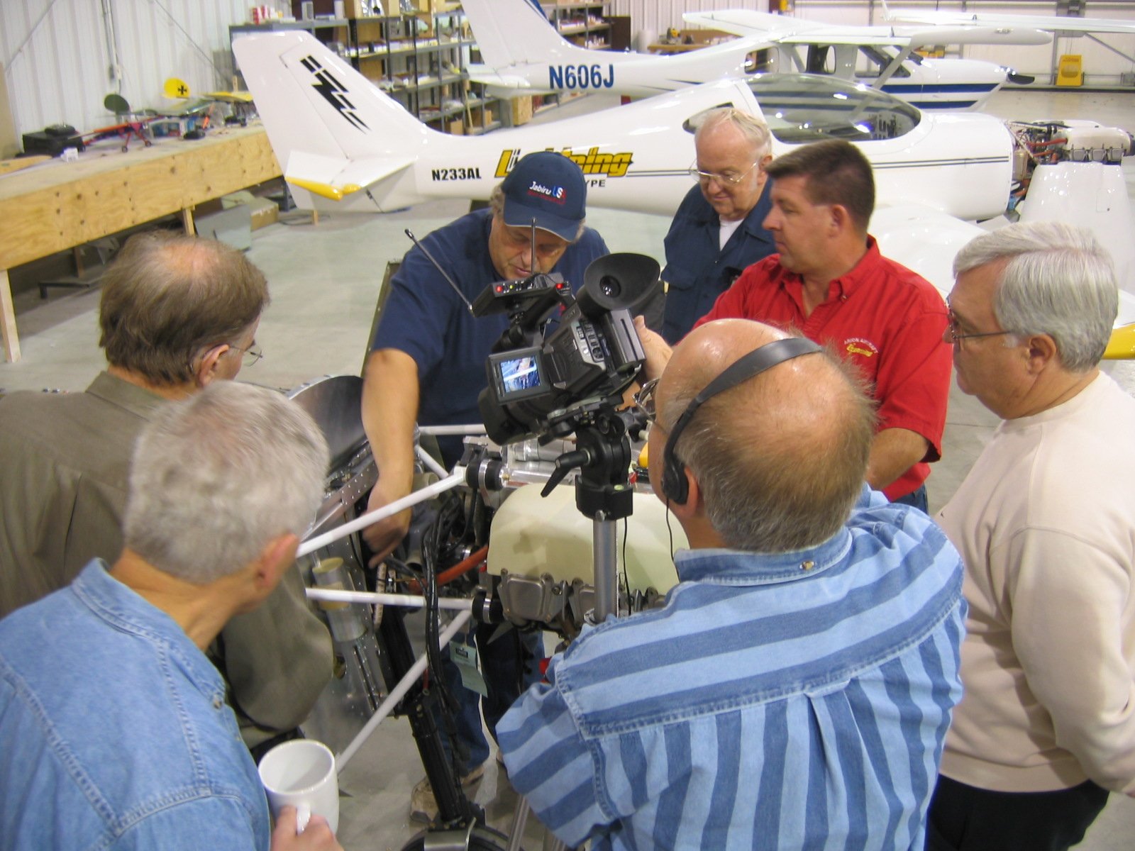

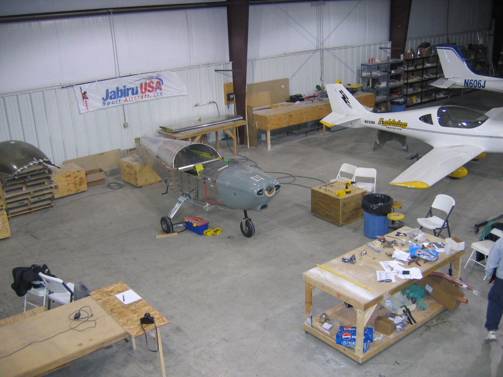

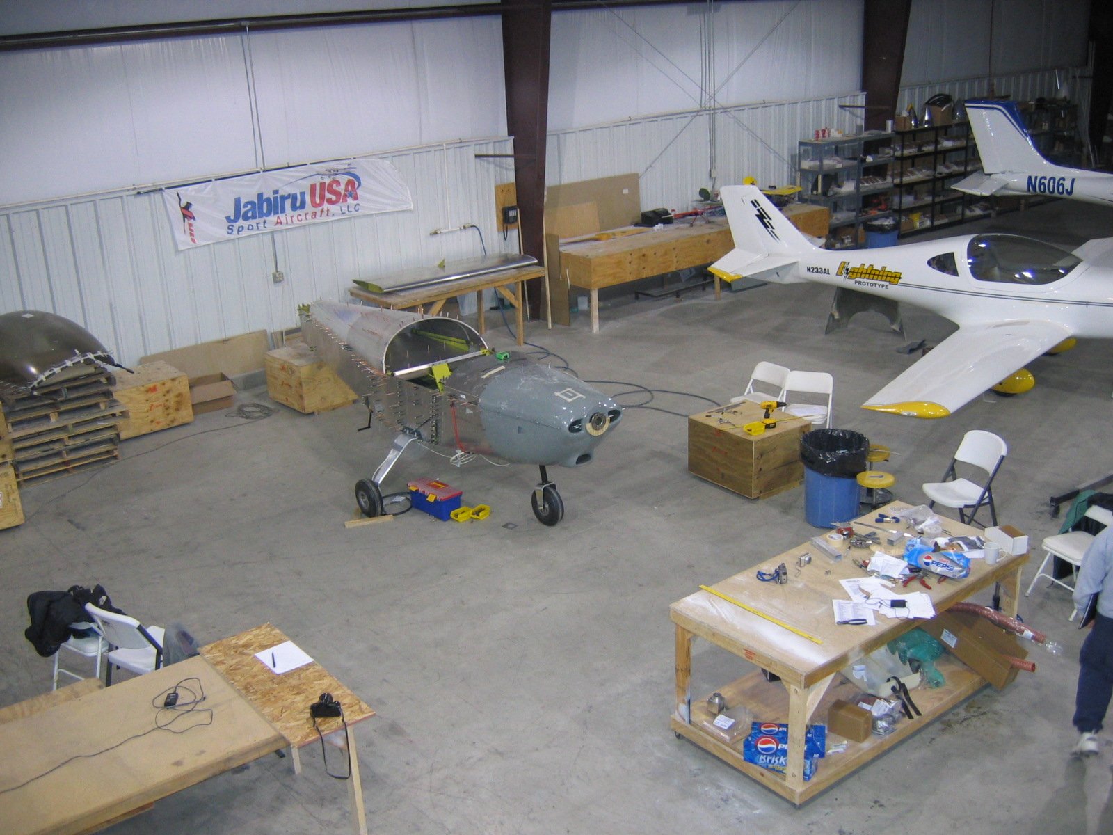

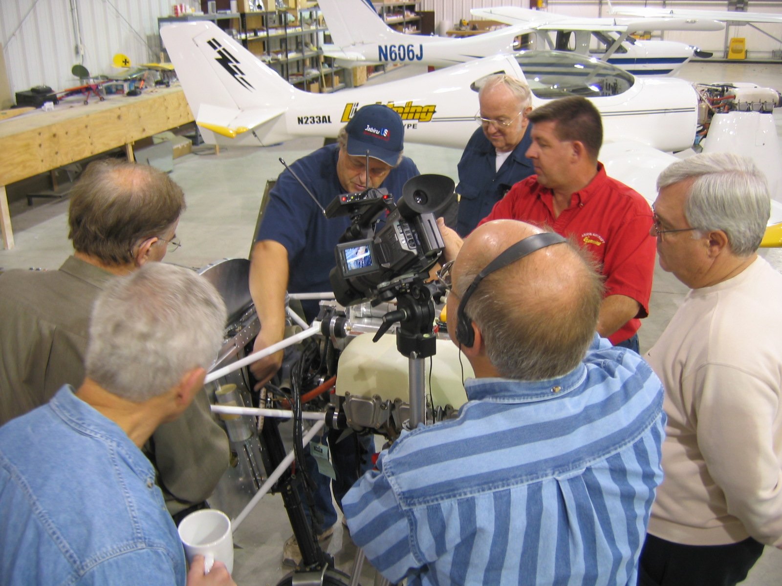

Jabiru held a very informative Zenith 601/Jabiru FWF seminar this past weekend at the Jabiru USA facility in TN. I had a good time and got to meet some fellow Matronic's posters there. My thanks to seminar leaders, Pete Krotje and Mark Stauffer, who were very patient with us as well as Don Guice, who's airplane we used as the guinea pig. Jon Croke was also there filming for an updated HomebuiltHelp.com video on this topic. One of the things I was interested in seeing was the dual throttle set-up. The latest ZAC firewall design requires some slight modifications in the way the cross-rod installation is performed on the top shelf. Nothing major, but you have to work around the front shelf L-brackets and the U-channel on the back side. Look for photo updates from Jabiru in the near future. We also went over the new oil cooler installation. I understand that new instructions hit the Jabiru web site just last week. Attached are a few pictures I took during the class as well as a shot of Don and his airplane loaded into a 30' Penske truck.

Jon Croke was also there filming for an updated Homebuilt Help 101 video on this topic.

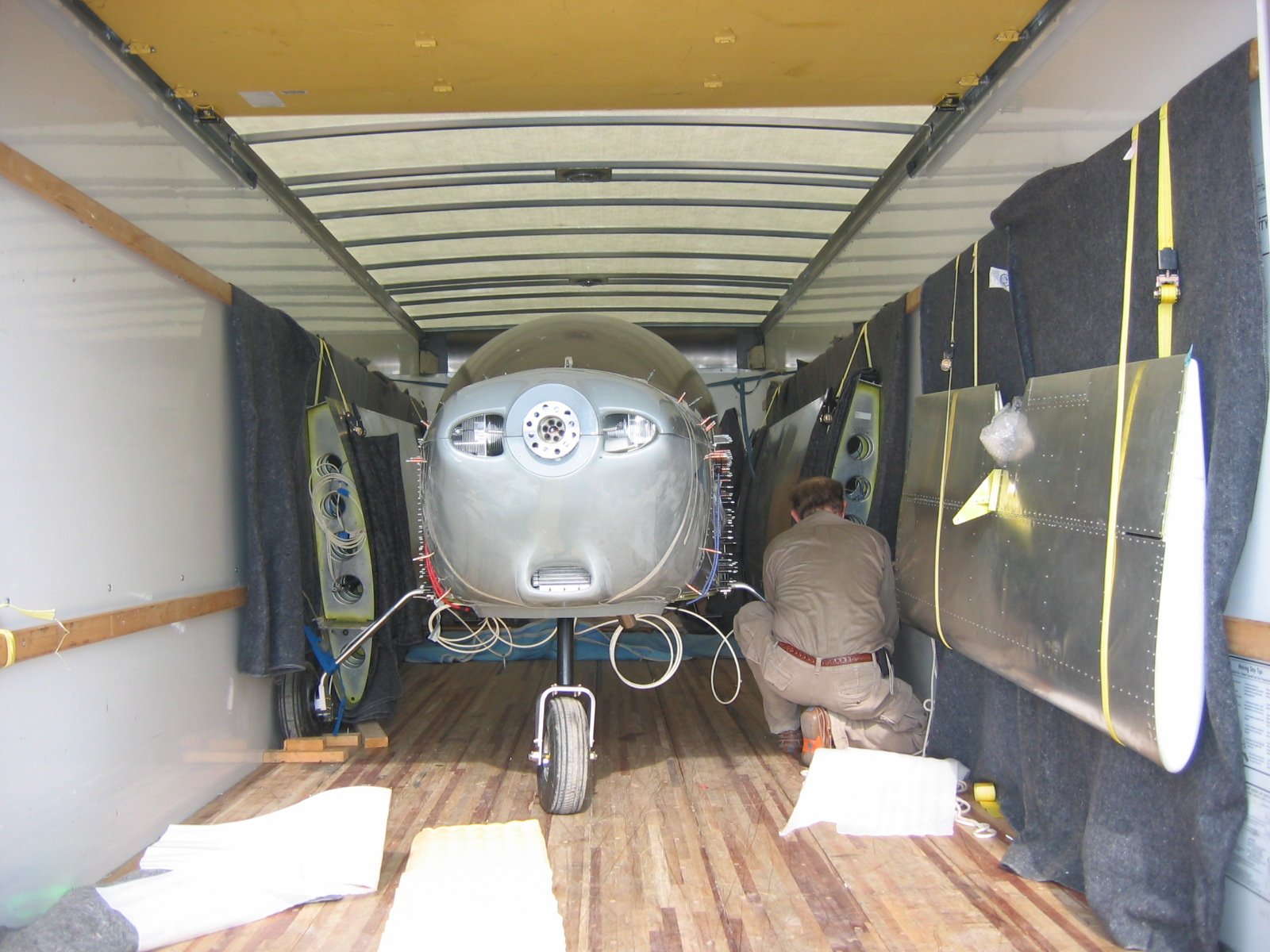

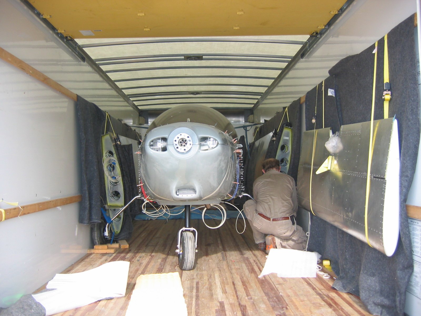

Jabiru held a very informative Zenith 601/Jabiru FWF seminar this past weekend at the Jabiru USA facility in TN. I had a good time and got to meet some fellow Matronic's posters there. My thanks to seminar leaders, Pete Krotje and Mark Stauffer, who were very patient with us as well as Don Guice, who's airplane we used as the guinea pig. Jon Croke was also there filming for an updated Homebuilt Help 101 video on this topic. One of the things I was interested in seeing was the dual throttle set-up. The latest ZAC firewall design requires some slight modifications in the way the cross-rod installation is performed on the top shelf. Nothing major, but you have to work around the front shelf L-brackets and the U-channel on the back side. Look for updates from Jabiru in the near future. We also went over the new oil cooler installation. I understand that new instructions hit the Jabiru web site just last week. Attached are a few pictures I took during the class as well !
