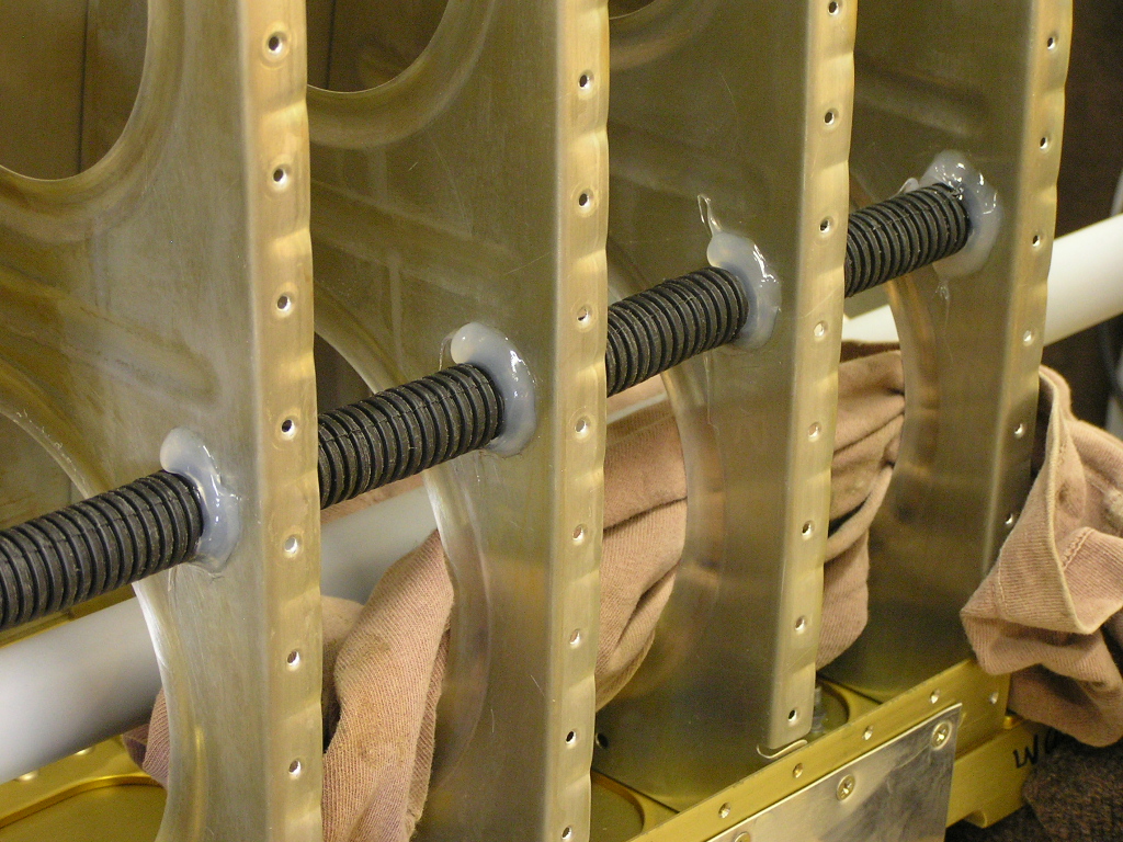

PostPosted: Mon Nov 19, 2007 2:09 pm    Post subject: Wiring conduit and lower skin riveting - RV-9 Wings Reply with quote
PS: Like this --- See attachment
John
