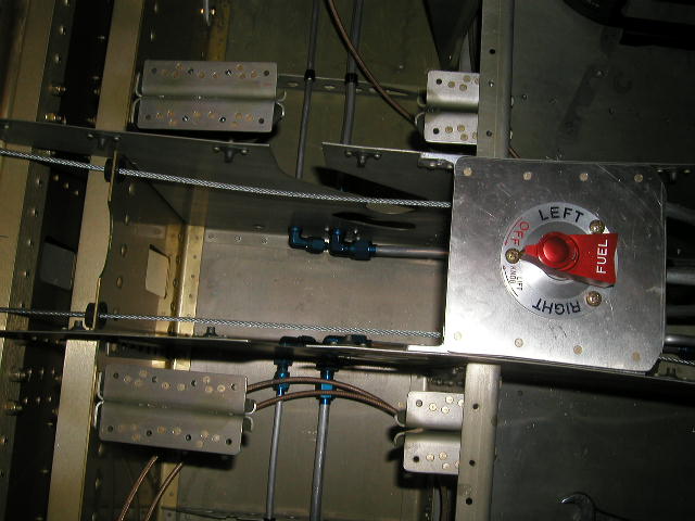

I wasn't happy with the tight bends needed to get the fuel lines out of the tunnel, nor did I want to use flex lines due to there service lifespan. Instead I used 90 degree bulkhead fittings, going thru the holes provided, but with .125 plates riveted over the holes, with the proper size holes for the fitting. Makes a very nice looking transition.

like this?

That is a fantastic way to do it for those who insist on sticking with
the hard AL tubing. Why anyone would try to fish those things through
and around with all the bends in it is beyond me. Good job David.

Ditto. I did the same thing. I wished Vans would have made these holes 9/16 so if you wanted to go this approach they would be unchanged and drill out to 3/4 for the standard installation. I made 1/16" oversized washers for both sides to use the bulkhead fitting. I used a 45 degree bulkhead fitting however.

I like those a lot. I thought about the same approach. May take it.
Thanks David and Chris

Forgot I had a picture of this on my site.
http://wcurtis.nerv10.com/08fuselage/fuselage37l.html

This looks like a good way to stay with hard lines so I just ordered
some bulkhead fittings to do it. Thanks for the pic showing how the
control system sits in there in the tunnel.
2 Questions - what is the second run of 1/4" tubing for?
Where did you get the aluminum washers? Did you fabricate?

Bill...those are the brake lines.

For those that would consider the bulkhead fittings; 90 degree fittings are best for the Andair valve, and 45 degree fittings for the stock valve.
Since the bulkhead holes are 3/4 inches, you will have to fabricate 2 - 1 1/4" OD X 9/16" ID washers from 0.063" aluminum.
Bill,
If you click on "Next Picture" from the below link you will see the plumbing for the fuel transfer pumps that attach those second 1/4" fittings. These pumps will transfer fuel from the wings tanks to a main tank behind the baggage bulkhead to maintain preset levels of 3, 5 or 8 gallons. Under "normal" conditions engine is fed from this main tank. If the pumps or electric should fail, I would revert to manual tank switching.
