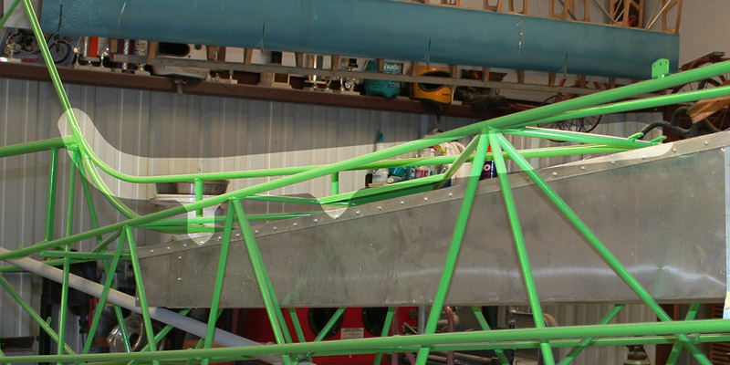

PostPosted: Sun Nov 11, 2007 8:40 pm    Post subject: uncoordinated turns Reply with quote
Jack sez:
...I was wondering if when it comes time to recover my plane if
maybe giving it a vertical similar to the Maule M-5 wouldn't help
keep it's heading easier? Has anyone ever tried this? It seems
like it could be done.
I assume you are talking about the extended leading edge of the
vertical stabilizer that curves into the top of the fuselage, right?
The dorsal fin, as it were?
I did that on my Kitfox. We welded a piece of steel tube from the
rear of the turtledeck to a point about 8 or 9 inches up the front of
the vertical tail, with a smooth curve just forward of the tail. We
also welded in a couple of vertical stand-offs to support the span.
I've highlighted this portion in the attached photo.
It made covering that area easier and I sure like the look. I don't
know how much improvement in yaw stability it provides because I
don't have anything to compare it to.
Mike G.
N728KF
Phoenix, AZ

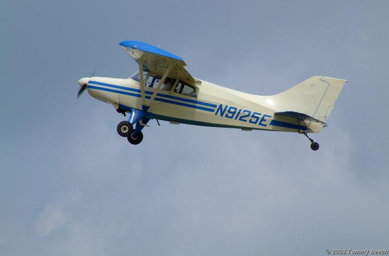

PostPosted: Mon Nov 12, 2007 10:06 pm    Post subject: Re: uncoordinated turns Reply with quote
Kitfoxmike, MikeG, and Dave,
Thanks for the replies. Attached is a picture of a Maule M-5 with the type of vertical I was referring to.
By the way, I went out to the dry lake again this afternoon for practice. It's getting a bit better each time. Even the landings went better. The fox really does get off the ground quickly and climbs out steeply.

PostPosted: Thu Nov 15, 2007 10:48 am    Post subject: uncoordinated turns Reply with quote
If you put as much of a blended strake as the Maule on your plane you may
want to consider also putting an offset into your vertical stab and the
strake to help counteract the rotation of the propeller.
Reminds me of an older Stinson.

PostPosted: Fri Nov 16, 2007 5:28 am    Post subject: uncoordinated turns Reply with quote
It's not the torque of the engine I was thinking about. It's the fact that the air from the prop swirls around the fuselage in the direction of the prop rotation. Several low and slow designs have the offset vertical stab. The problem with is is if you change the direction of prop rotation, like my 582 to 912 change out, the offset will be going the wrong way.
You didn't notice yourself pressing the right pedal at cruise?
Noel
