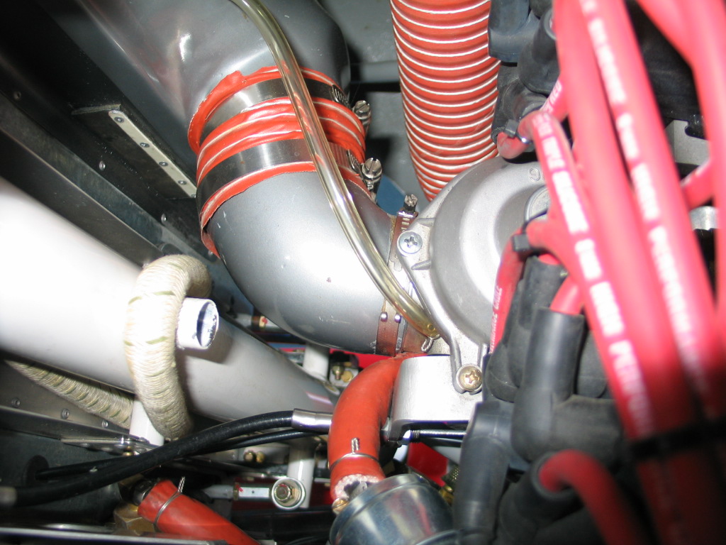

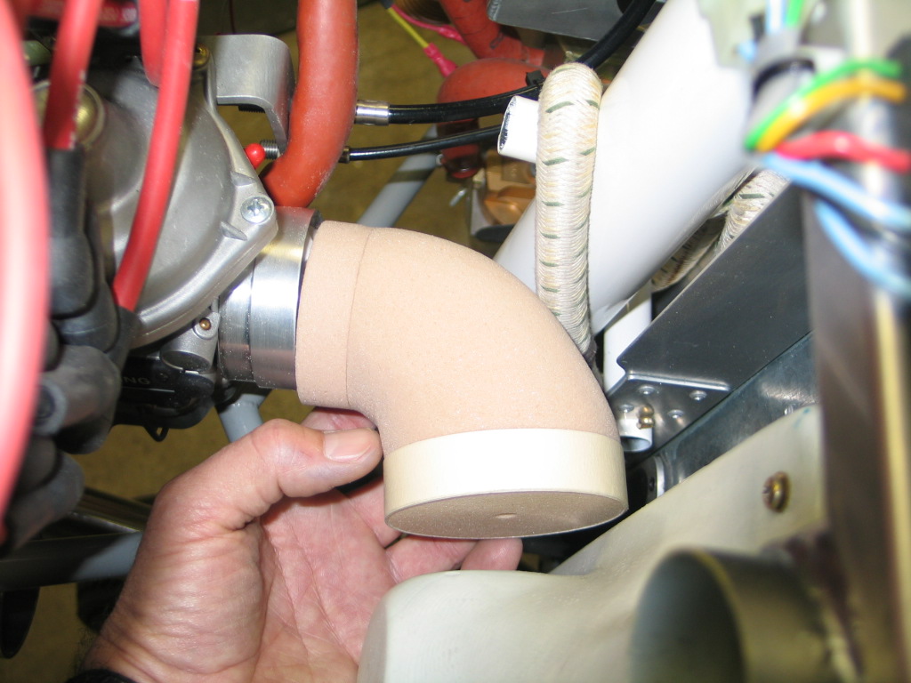

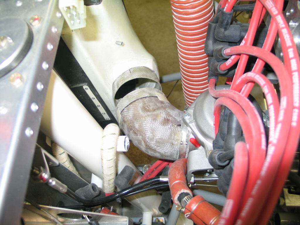

PostPosted: Sun Nov 11, 2007 8:05 am    Post subject: Carb jet changes Reply with quote
Here are some pics of the intake elbow I made.
Zodiac 601HDS, 3300 Jabiru (350 Hrs.)
Al from Oshkosh
 Filesize:  195.99 KB
 Viewed:  1239 Time(s)
 Filesize:  243.05 KB
 Viewed:  1174 Time(s)
 Filesize:  227.99 KB
 Viewed:  1204 Time(s)
Lynn Matteson
Posts: 2778
PostPosted: Sun Nov 11, 2007 2:33 pm    Post subject: Carb jet changes Reply with quote
I see that you have the air inlet tube coming in from the side. This
is what I was warned against, both in the workshop at Sun 'n' Fun and
in reading the instruction "manual." They say the airflow should come
in from below or above, not from the side, as coming from the side
sends different signals to the two air sensor ports in the top of the
carb throat. But with 350 hours on yours, it must be working well.
I've got ~435 on mine and it works well. I guess that's why we
experiment.
