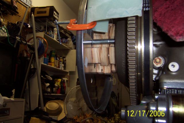

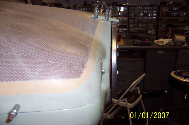

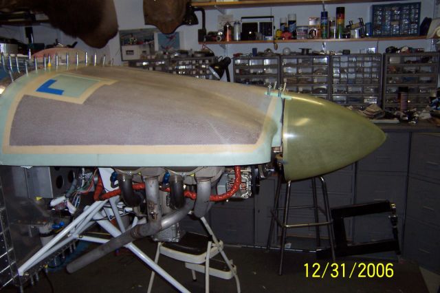

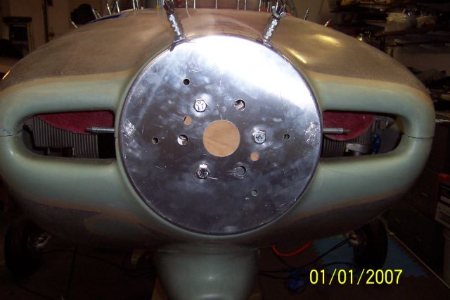

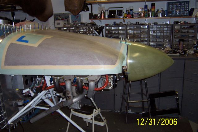

I know this isn't a 10 but I'm not sure why the prop or hub is is really necessary. I had a bulletin from Vans and they gave me the dimensions for a spacer which was 2.25 inches as I remember it. I took three round pieces of 3/4 plywood plus several nickels for spacers in spacers Wink to make it exactly 2.25 and put the spinner plate on. I have already fit the cowl and sure hope I haven't messed up. See pix.
The cowl fits better than the pictures show due to the angles and the prop spinner to cowl gap will have to filled a little to make it perfect but who knows if the engine will sag a little etc, so my plan is to get it close, fly it awhile and then fiberglass to final fit.
This is on a 7 but I suspect the same method would work on a 10. I will be glad to scan and send the bulletin if anyone wants to see it. They actually said to fit the cowl without the prop because it makes it so much easier to get on and off what seems like a 1000 times.
Hope this helps
Bill S 7a Ark

The photos of your 7 are very nice. I wish the 10s spinner mounted the same way. The back plate isn't held in place by the prop bolts but rather by the bolts that hold the constant speed hub together. At least that's how I read the plans. Your posting did give me an idea, I'm headed up to Van's tomorrow and I'll bug them for any ideas. If they have anything new I'll drop an email to the group.

Probably right, not sure about the 10 but actually the plate you see does bolt to the prop hub. In finished form, the center of the spinner backing plate (shown) has to be cut out for the hub to pass through and the spinner plate (shown) actually bolts to the CS hub with the smaller plate on the front of the hub. Then the CS hub itself bolts to the crank. It just works out that the spacer puts the spinner plate in the right place 2.25 inches from the flywheel face. I supposed that is why they ship the spinner plate drilled but not cut out so that you could do this or use it on a fixed pitch prop as well. If I am not mistaken, the fixed pitch prop is exactly 2.25 inches thick as well which is why it works for either one. Anyway I have already said all I know. Wink
Obviously this is in principle and the 2.25 dimension probably only applies to the O-360 series engines.
For what it's worth, I found the document and attached a JPG copy.
Good luck!
Bill S

.ExternalClass .EC_hmmessage P { PADDING-RIGHT: 0px; PADDING-LEFT: 0px; PADDING-BOTTOM: 0px; PADDING-TOP: 0px } .ExternalClass EC_BODY.hmmessage { FONT-SIZE: 10pt; FONT-FAMILY: Tahoma } I know this isn't a 10 but I'm not sure why the prop or hub is is really necessary. I had a bulletin from Vans and they gave me the dimensions for a spacer which was 2.25 inches as I remember it. I took three round pieces of 3/4 plywood plus several nickels for spacers in spacers Wink to make it exactly 2.25 and put the spinner plate on. I have already fit the cowl and sure hope I haven't messed up. See pix.
Hope this helps
Bill S 7a Ark
Boo! Scare away worms, viruses and so mdard/en-us/purchase/trial.aspx?s_cid=wl_hotmailnews' target='_new'>Try now!

here's a quick pic of the prop hub i acquired from a prop shop for 40 bucks shipped. its unairworthy of coarse and he needed to be convinced i wasn't going to try and fly behind it. DUH.. i figured when i was done I'd release it into RV land and let rv10 builders pass it on...
steve dinieri
iflyrv10.com

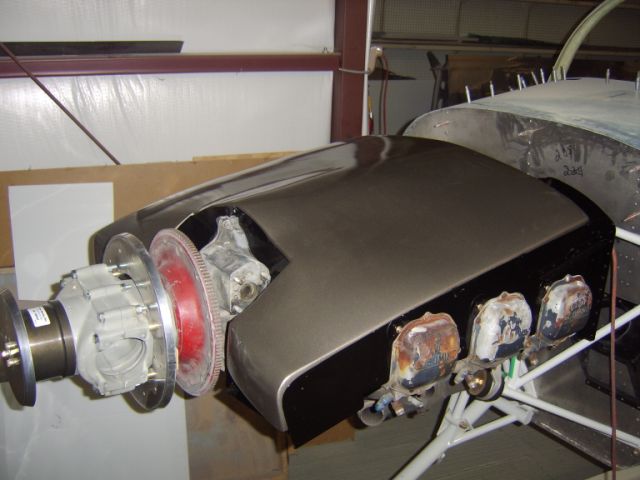

OOps, meant to say the fixed pitch prop spacer for the FP is 2.25 inches on the 7, not the prop itself. Again, may not apply to an IO540 but an old hub or the correct spacer size from Vans for an IO540 would take all the guesswork out of it.
Bill S
From: owner-rv10-list-server(at)matronics.com [mailto:owner-rv10-list-server(at)matronics.com] On Behalf Of Bill Schlatterer
Sent: Monday, November 05, 2007 9:55 PM
Subject: RE: cowl fitting tips.
Good luck!
Bill S

Remember not to drill the spinner front plate that you already have installed in the hub. The orientation of the cylinder on the front of the hub may not be the same on all props.
Nice-looking plenum, but how does the air get in there? J

hey Jessie,
are you suggesting not to drill the front plate to the spinner cone?

I am suggesting exactly that if prefitting the cowl with a dummy prop hub. If you have your final prop, then you can drill it, of course.
Jesse Saint
Hope this helps
