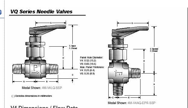

Does anybody have a source for a valve that will open the static
system (1/4" Tygothane plastic tubing in our case) to cabin air?
normal position would be "closed" of course, so that the static
system is only open to the static ports. Alternate position would be
open to the cabin OR to both the cabin and the static ports.
I'd like to mount one on the far right side of the panel, but can't
seem to track down a suitable valve.
Any leads will be greatly appreciated.

I used something very much like these:
http://www.valinonline.com/product.asp?prodid 733
You can get them with various fittings, bulkhead mount them,
and they seal well and open with plenty opening to work
well.
My Beech's specified location for it was on the trim panel
by the pilots Left knee, similar to just above where
some Pipers put a fuel valve on the sidewall. I used that
concept for my -10 and mounted it just forward of the air
vents near the top of that trim panel. The lever is mounted
pretty close to the sidewall and it would be hard to snag
it open. I know some people put them in the actual panel,
but there's really no need to be THAT accessible. You
do want it in a place you can easily reach to activate
if your static ports freeze up.

John, Safeair sells an alternate static port. It's a pretty simple
system. Just a plug that fits into a quick connect fitting also
available from MSC supply.
http://www.safeair1.com/index.htm
