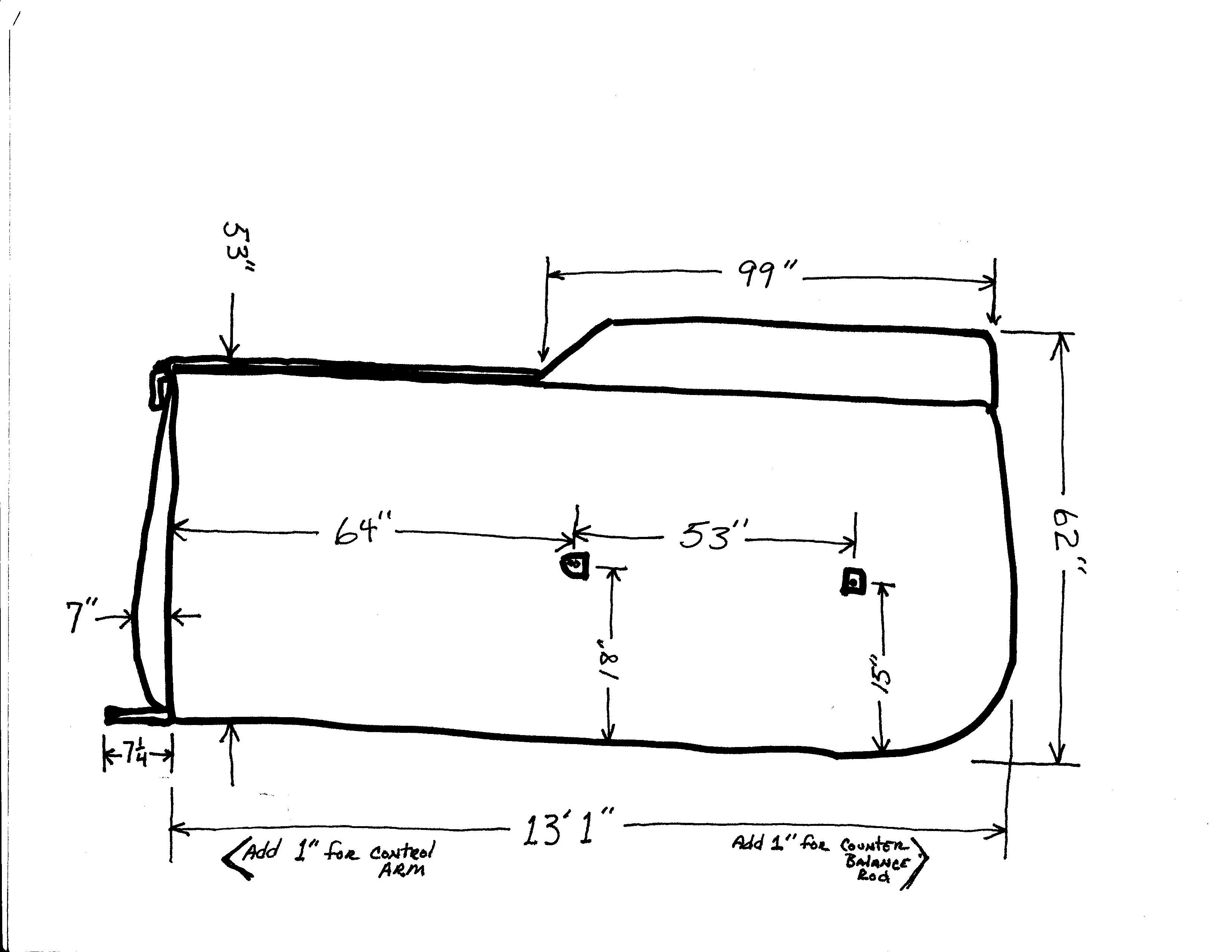

The cord lenght is a Combination between the wing and the ailerons ( 61" ).... I don't think "that" is the number your looking for...
Your looking for the dimensions of the wing & Aileron....
My Wings are in the Garage....If you need the measurements...
I'll get them...
Gotta Fly...
Mike & "Jaz" in MN
| Quote: |
[quote="Bob Dresden"] What I need to know is the total chord w/ailerons so as to modify the rack accordingly.
[b] |
OK,
I'm Back with the dimensions..... ( attachment )
This should cover Everything that you need....( and more )
My wing and ailerons are "stock"........( except bracing )
Gotta Fly...
Mike & "Jaz" in MN
| Quote: | modify
I believe the http://www.tnkolbaircraft.com/ Site says that it is 64
inches, however mine measures 66 inches. Good luck.
Larry C

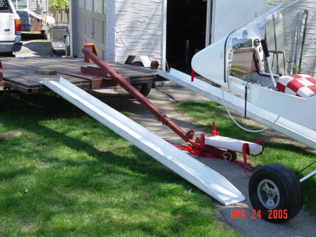

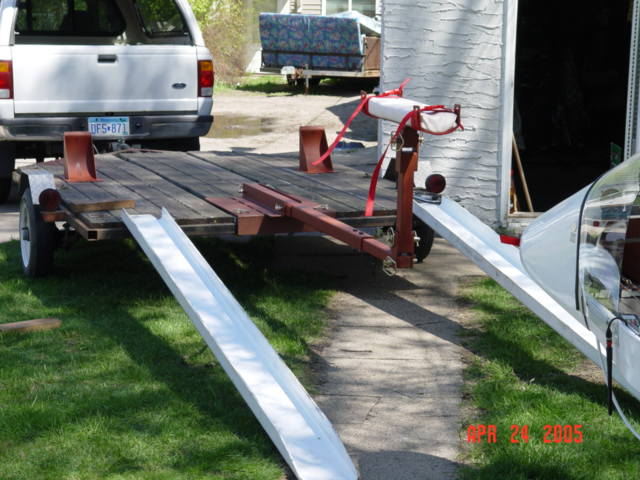

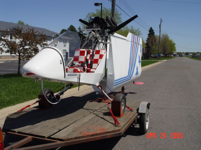

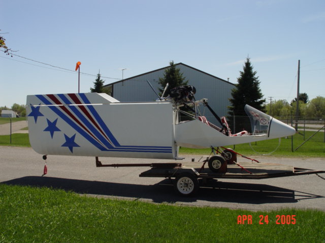

Posted: Mon Oct 22, 2007 2:29 pm Post subject: Re: Lurker on the loose |
Pictures...
I can Haul Azz with the plane on the trailer this way.....
Like a fish headed up stream.
and the way the trailer and "arm" are set up....it's a gentle ride
Gotta Fly...
Mike & "Jaz" in MN

Posted: Tue Oct 23, 2007 11:18 am Post subject: Re: Lurker on the loose |
Mike,
Thats a great setup you have made for hauling your Kolb.
I'll be making something similar out of my spare single Seadoo trailer.
Secured at the tires and supported along the boom with a bracket and straps is ideal.....Headfirst of course!
Nice!
