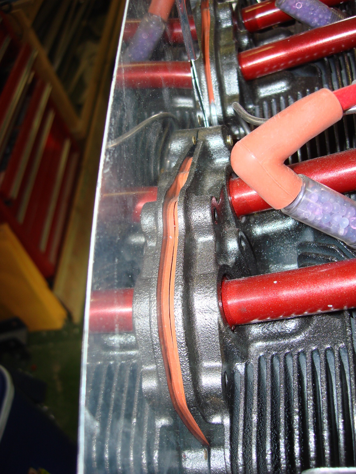

Hi,
does the baffling need to be on top of the rubber gasket or in front of it?
See attached picture.
Michael

Michael, I think that metal baffle should be flat against the cylinder,
so you may want to sand or file slightly to make it go around the
gasket. Not sure if it really matters a huge amount, but you'll
want it to seal well either way. It seems your gaskets may be just
a little larger than some. If it likes sitting there though with
no stress on the metal, you could RTV it too if you wanted. Just
make sure it seals well.

As Tim said, it mainly needs to seal, but it is best if you have it flat
against the cylinder. I would probably try to trim the gaskets a little
first to get it to pass, then my next move would be to trim the metal a
little, but there is not a lot of extra room around the edges.

Thanks Tim & Jesse,
I'll make it fit föat against the gasket.

My bafling is against the metal not the gasket also.
