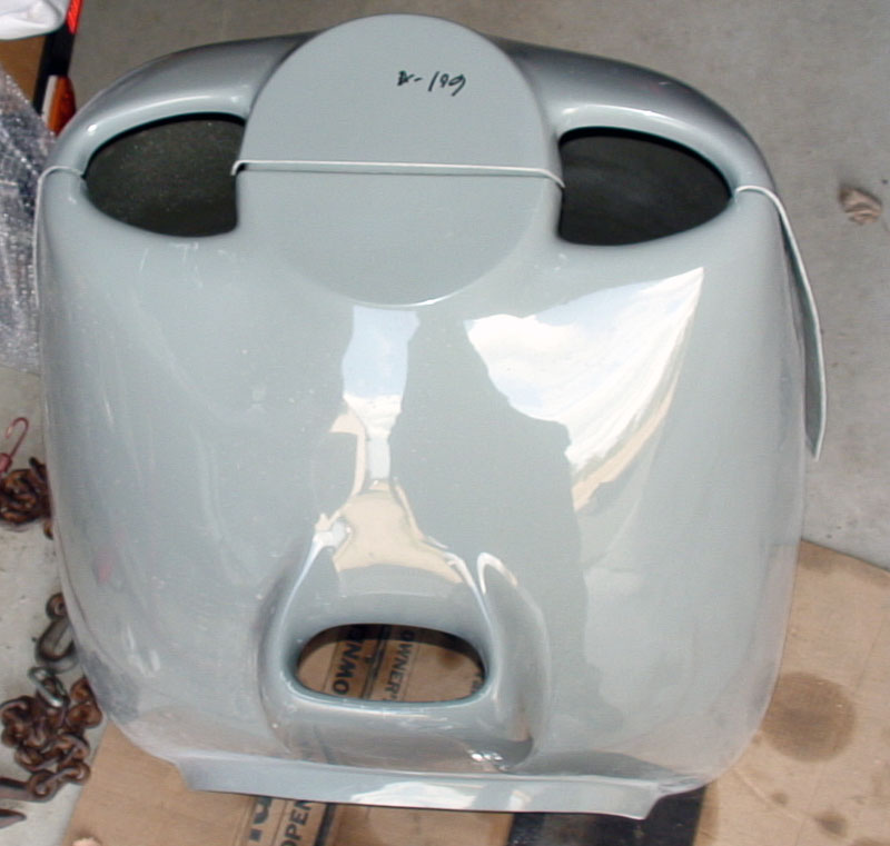

craig(at)craigandjean.com Guest
Posted: Wed Oct 17, 2007 8:04 am Post subject: 601XL Jab3300 cooling |
> On Oct 13th at the Zenith fly in at Cloverdale, 3 of the 601xl's /Jab3300 equiped planes had an exterior air scoop on the 2, 4, & 6 side!
Two of the three were N601FW (Alan & Nathalie Smith) and N601WF (Stephen Smith). The reasoning is that the vents on the cowl (from Jabiru Pacific) slope back. On the side where the prop blade swings up the air bypasses the vent. So the eyebrow vent keeps the air from bypassing the vent. I don't remember what improvement was seen.
You can read about building the twin planes in 4 months here:
http://www.qualitysportplanes.com/qsp-2006_072.htm
-- Craig

Tim Juhl
Joined: 21 Mar 2006 Posts: 488 Location: "Thumb" of Michigan
Posted: Wed Oct 17, 2007 8:15 am Post subject: Re: 601XL Jab3300 cooling |
I see what you mean...... seems like there are some serious design issues with that cowling. The pix of the latest from JabiruUSA is attached. I hope it works a little better.
Tim
