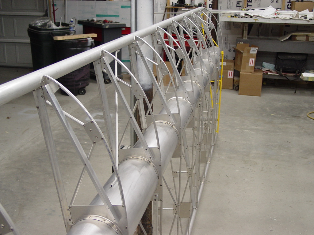

John or anyone Got a picture of where to install the 1/2" aluminum angle bracing in the the wings ?
I would like to do this before I start the covering Job and if theres anything else that needs attention I would like to hear from you about it

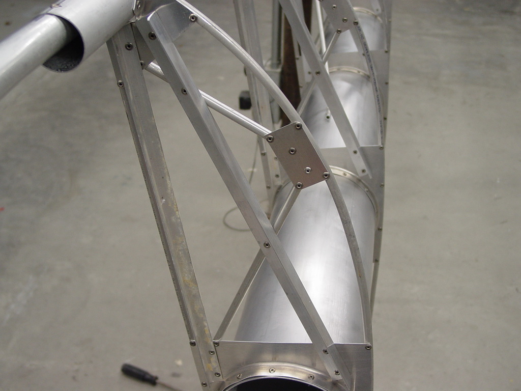

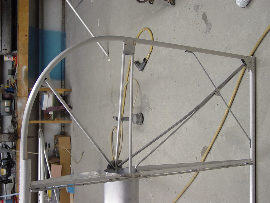

Here are some pictures of the Angle Aluminum wing bracing. Don't forget to put some extra bracing on the wingtips also, they are prone to flutter at high speeds in the stock configuration.

I must have missed something somewhere, Why is it that all of those ribs in
that wing shot have angle bracing on them? Is that called for in the plans?
I understand why the outboard rib gets it, but why all the others?
Jim
JetPilot
Posts: 1246
PostPosted: Wed Oct 10, 2007 8:39 pm    Post subject: Re: Kolb-List:Wing Bracing Reply with quote
The bracing makes for a stiffer, stronger wing that will handle many years of fatigue better. If I ever get in a monster wake, or other event that puts a huge amount of G's on the plane, I will be very glad to have the extra bracing throughout the wing, not just the tips. The loads are carried by the ribs on the entire wing, not just the tips. Its only very little extra weight, maybe a couple pounds, and its well worth doing.
Mike

Rib stitching will also help but those angle braces are some very good insurance.
I know those ribs are weak laterally due to the rivet holes in the upper curvature as I found out first hand from some over shrunk Poly Fiber so the extra bracing is a good thing.
