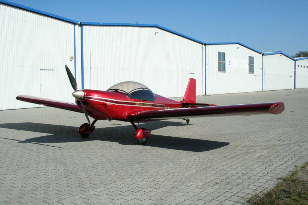

i did see some pics on the website from the open day and i liked very much the 601xl from Mike Canion. I would be interested in the wing root fairings does anyone no how to contact him or how I could get some of those fairings

That's gotta be a beautiful airplane. Do you have anymore pix of this?

I talked to him but did not get any contact information. He said he laid
them up over clay. I asked if he had done much fiberglass work and he said
he hadn't. They really looked nice!! I would love to have some myself but I
don't know if I feel like tackling the job.

They really make it look like a production plane. I like it. Wheel fairings too.

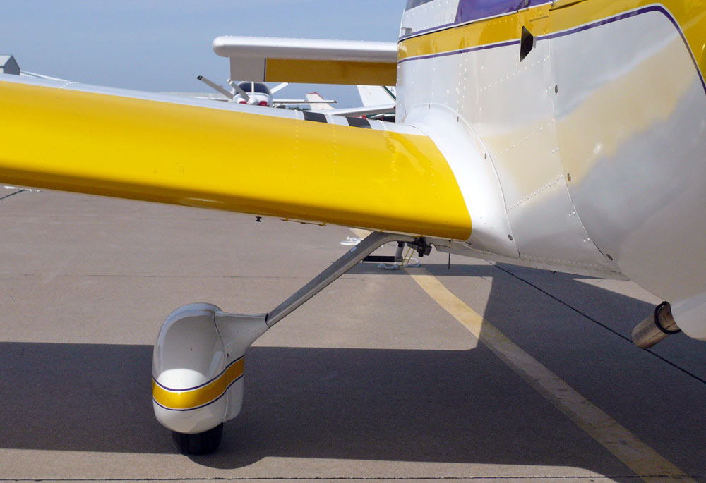

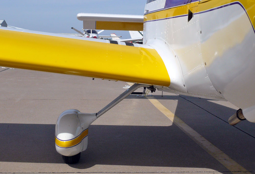

The fairings were very attractive. My concern with those fairings is that
they are of constant width, and thus probably would not provide the
improved aerodynamics that Klaus Truemper was able to demonstrate with the
fairings that he put on his HDS. Klaus' analysis was that the junction
between the fairing and the wing needed to be a straight line from the
front of the wing to the wing trailing edge. That requires that the fairing
be significantly larger at the front and rear of the wing than they are at
the widest point on the fuselage. For details, see:
http://www.utdallas.edu/~klaus/Airplane/wing_root_fairing.html

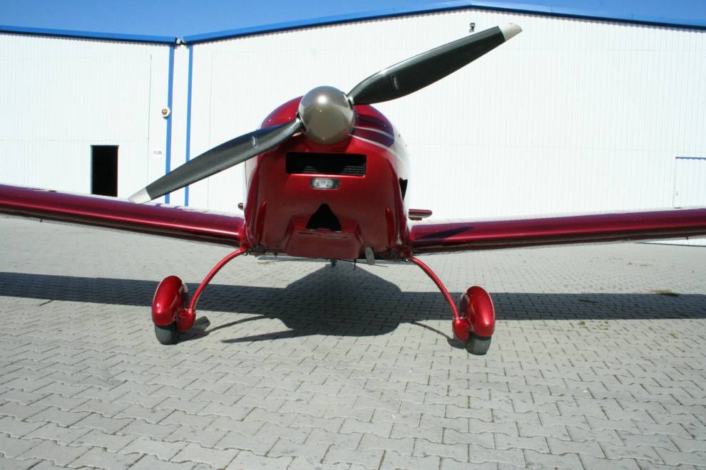

I got some fairings for a TD (see pic) but i need some for my CZAW trigear.
If someone would like to have them for the TD i can send them price is 50 USD
also I have cover for the brake calipers for the main gear to fit the CZAW wheel fairings.

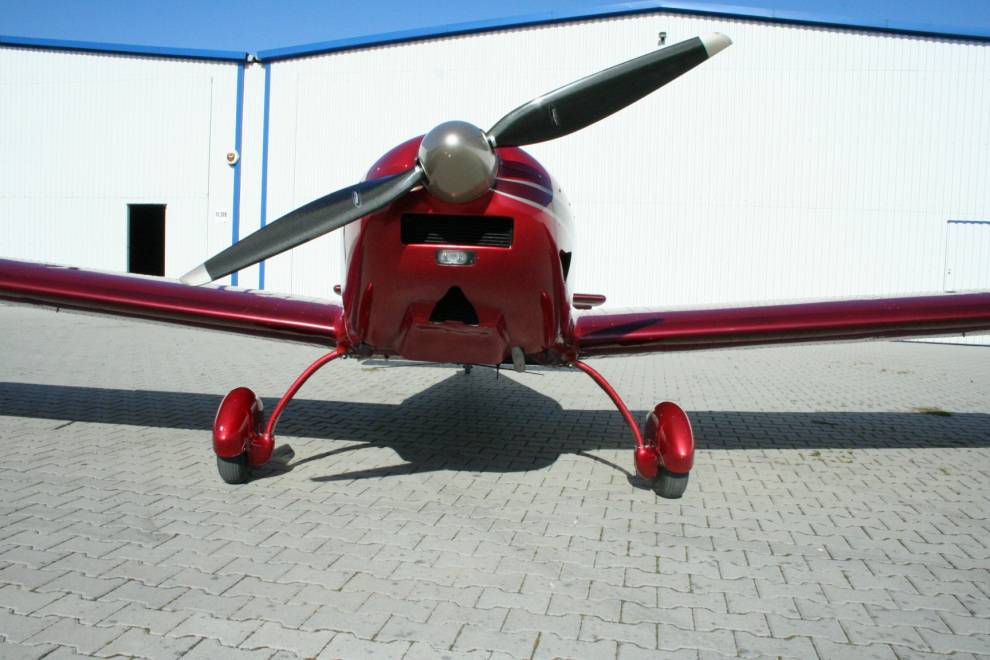

and one more
