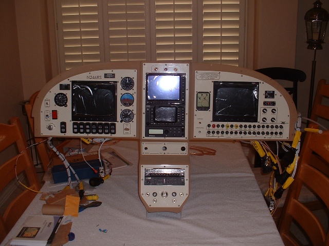

You pretty much described my panel, dual AFS-3500, MX-20, GTX330, SL-30, GNS-480, RV-10 AP, PMA 8000, MC 2.25 CDI, Backup AS & ALT, GDL-69A. Accuracy built mine, I am very happy with them. I get no perks for recommending them. They did what they said they would do for the costthey quoted me and delivered it when they said.

Rick got any pictures?
Ben

Heres one prior to install, installed ones were too blurry, need a better camera, can't afford one now
Rick S.
