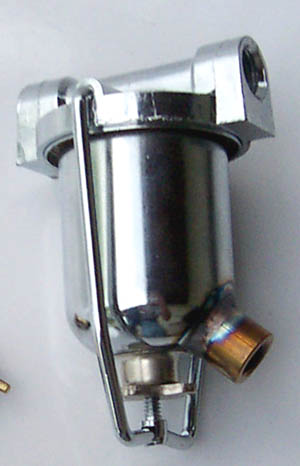

PostPosted: Fri Oct 05, 2007 6:17 pm    Post subject: fuel filter160163215628 Reply with quote
Seems that I remember someone was looking for a filter like this early this year.
Ebay #     160163215628
http://cgi.ebay.com/ebaymotors/Brass-Bronze-Fuel-Filter_W0QQcmdZViewItemQQcategoryZ33550QQihZ006QQitemZ160163215628QQrdZ1QQsspagenameZWDVW
only 19 hrs left

PostPosted: Fri Oct 05, 2007 6:43 pm    Post subject: fuel filter160163215628 Reply with quote
That's better than most of the tractor gascolators I've seen... but I was looking for something with a drain, like I had on my '41 T-Craft.
I now have one of the inline filters with a glass body from the auto parts store on my Ultrastar... not as convenient, but I can unscrew the ends if I really need to.

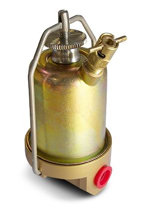

Our Allegro has a small glass bowl gascolator w/o a drain so we were looking for an equivalent with a drain but could not find one. We ended up buying one from Great Plains Aircraft for $36. Metal bowl but inexpensive and well built. See attached photo. It takes a standard 1/8" NPT threaded Curtis or Safe-Air drain valve.

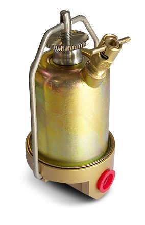

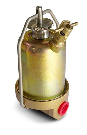

Here is the Gascolator that is going on my Kolb. It is meant for experimental aircraft, and is only 67 dollars. Comes with a drain and a modern unbreakable design.
http://www.aircraftspruce.com/catalog/appages/acsgascolator.php
Glass is prone to cracking and breaking. Seems if you want glass, you are getting so focused on one issue, that you are ignoring the more important breakage issues. You cant see gas in the fuel drains on most Cessna and other GA aircraft... If you want to see the fuel coming out, drain in a clear container.

PostPosted: Sat Oct 06, 2007 2:49 pm    Post subject: fuel filter160163215628 Reply with quote
PostPosted: Sat Oct 06, 2007 3:49 pm    Post subject: fuel filter160163215628 Reply with quote
> If you plan on ever using pump gas in your Mk-3, do not use that ACS
gasculator! Pump gas will ruin its gasket in a couple minutes and it will
leak like hell.
Ask me how I know? Thegasket only holds up to 100ll.
Denny Rowe

Probably why they sell a replacement gasket for auto fuel
REPLACEMENT GASKETS
AUTO FUEL 10536-1 06-00441 $5.45

PostPosted: Sat Oct 06, 2007 3:52 pm    Post subject: fuel filter160163215628 Reply with quote
Kolbers..
Guys I think this is the same gascolator I ordered from
Aircraftspruce and it also said that it was not to be used with auto gas. I
ordered it anyway because I could not find one like I wanted except one for
a farm tractor. I went over to the auto parts store and bought some gasket
material that was compatible with gasoline and cut a new gasket. That was 5
years ago and I have never had a leak.

PostPosted: Sun Oct 07, 2007 2:07 am    Post subject: fuel filter160163215628 Reply with quote
Denny R:
REPLACEMENT GASKETS
John, Thom,
That is good news, ACS did not have that back a couple years ago, I guess my
old gasculator is not worthless after all. I even went to the trouble of
machining a bowl from billet that used a viton o ring but was unhappy with
the weight, I never tried Thoms idea of using a differant gasket material.
Denny

PostPosted: Sun Oct 07, 2007 6:34 am    Post subject: fuel filter160163215628 Reply with quote
"Mike,
leak like hell.
Denny Rowe "
Ditto on the gascolator from Great Plains, and wait till you try to mount
it.
The bail bends, the thumb screw is next to impossible to center, then you
have to safety wire it.
I threw mine out!
I got the blue aluminun jobbie from Spruce.
2 ports out plus one 1/8 for a primer.
Direct mount.
Vic
Maine
