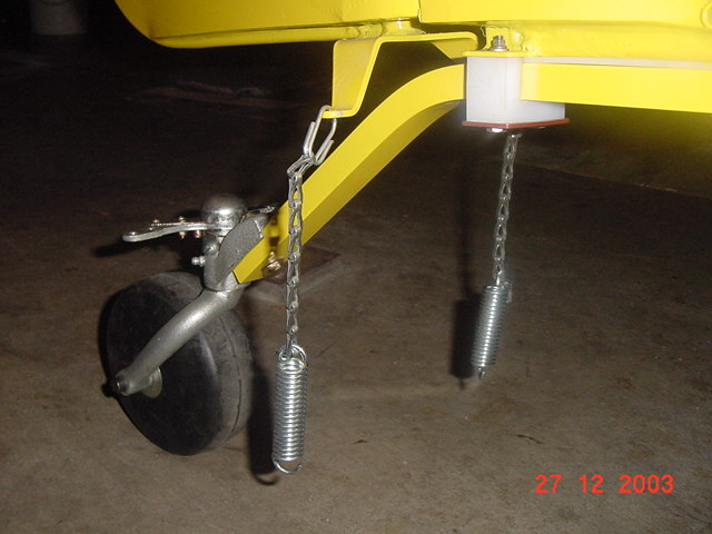

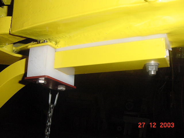

Yes John, I have a grove aluminum tail spring and seems fine. I have mounted mine in a nylon block as I read that some past failure was due to stress cracking caused by the spring rubbing on a mounting bolt. See http://www.sportflight.com/cgi-bin/uploader.pl?action=view&epoch=1072508647 for pictures. John A.

Thanks for writing back, and a big thanks for the pictures. I would never
have thought of that. It is a great way to protect the spring and I believe
it is a bit more control over the sway of the gear. I will do that same
thing to mine this winter.
