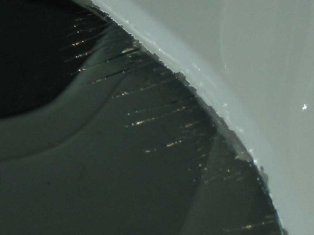

Every now and then, I mention the wealth of information that has been posted by Tim Olson and our RV-10 University archives. It seems so tragic that the mistakes of a few can be repeatedly resurfaced due to avoiding a read.
For those who chose to be research impaired, here is a post http://www.myrv10.com/tips/maintenance/plexi/Care_of_Plexi.pdf
For those who need a picture – see attached.
Before using ACETONE. Understand that it is a great solvent, faster than Isopropyl Alcohol, slower than MEK and leaves a residual. Is great for cleaning composites prior to bonding skins together. When used on Plexiglas, Lexan or Acrylic (aircraft windows) it dehydrates natural lubricants which inhibit crazing.
Go ask an aircraft window supplier what they think is the consequence of ACETONE touching your windows. They are a real bitch to replace. It would be unfortunate not to revisit this subject. Also, Jesse has never shared his process for replacement of that damaged windscreen and the adhesion of it to the aircraft during initial construction and windshield replacement procedure. First time builders would love to know.
Sorry Chris, your enthusiasm can sometimes overwhelm us old fogeys. I will stand by my source of LP Plastics. Fifth paragraph Third sentence.
Been there, done that, won’t ever, ever consider it again – whoever David is “as provided”.
