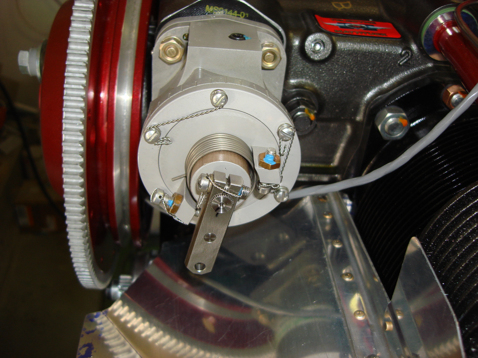

I installed the prop governor a couple days ago but I thing that the orientation of the lever is wrong.
Before I cut the hole for the cable in the baffeling assembly I want to be sure that this is right?
If you could attach a picture of your installation that would help most. I used the MT FWF Kit and the governor came as you see in the picture.
Michael

Michael,
This photo may help:
http://www.myrv10.com/N104CD/maintenance/20061022/RV200610220012.html
You just loosen the screws and rotate it. Don't remove screws.
For the newbies, pay attention to the responses here because
this question comes up often. Yes, you have to rotate the
arm position on the governor, and then it will work. It's kind
of an 8 o'clock to 11 o'clock rotation if I remember correctly
but others may chime in because it's been a long time since
I did this now.

Michael,
Loosen the 5 screws on the face plate and clock the lever around to the 10:00 position.
Mark

Great,
thanks for your answers.
Michael
