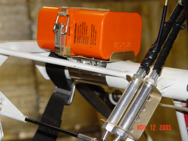

Here is where I mounted my ELT. I made a bracket to hold it on the top of the tube, butting it up against the front wing attatch bar. This is in a Firestar, and I was just out of room. I mounted the remote on the right side of the nose cone.

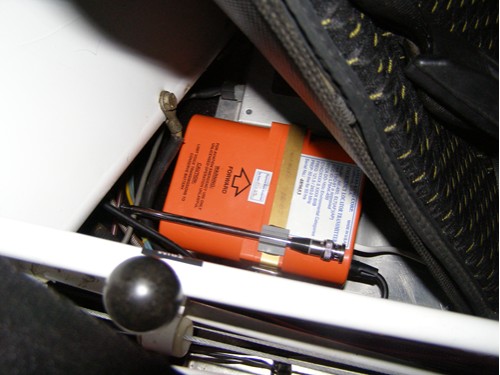

In my MkIIIC, I put my AK-450 ELT behind the left seat, mounted on a tube. The remote control was placed, of course, on the panel. The hard parts were the ELT mount, which I had to fabricate, and then a place to put the antenna, which, again, I had to find a place for (I made an aluminum "box" that fits around my large capacitor) and fabricate a mount.

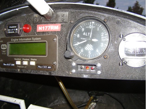

Thanks Larry and everyone else for the help and pictures. I talked to my DAR this morning and he said if the ELT can be turned on easily from the pilot seat, the remote was not mandentory. I will decide where to mount it when it comes in and go from there...thanks again, Mike

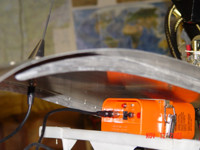

PostPosted: Thu Sep 06, 2007 3:00 pm    Post subject: Re: ELT Installation Reply with quote

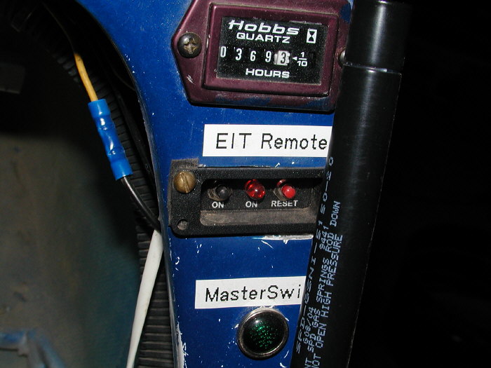

The Remote , isn't for your convenience.....It so you can
see the "Light" in case the unit was accidently turned on.....
it's supposed to be mounted where you would see it ....
Gotta Fly...

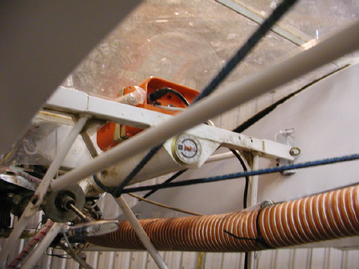

Here's how I did it: For installing a AK-450 in my Mark-III, I attached
it to the side of the six-inch tail boom tube, near the forwardmost end
where it attaches to cage structure. I fabricated a pair of wooden
saddle blocks to interface between the 6" tube and the flat ELT base.
Two large hose clamps hold the setup securely against the boom tube.
Access to the ELT switch is easy, right behind the pilot's seat back.

Thanks Dennis......I got a nice surprise yesterday when my ELT arrived from aircraft spruce. The remote switch was included! I dont know why, but I was afraid it didnt come with the elt and I would need to make another order. Thanks again, Mike

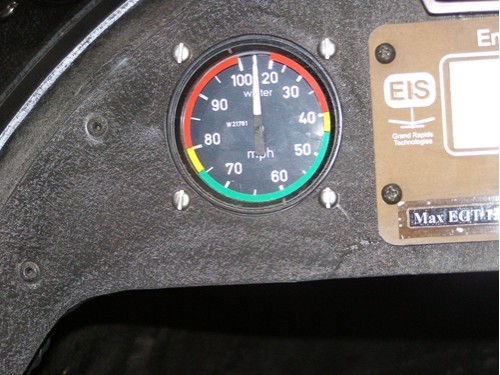

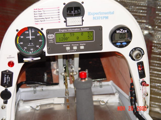

PostPosted: Tue Sep 25, 2007 5:21 am    Post subject: Re: ELT Installation Reply with quote
Never exceed speed for Mk ll is 80 mph according to the old construction booklet I acquired with my plane....Stall speed is about 37 mph for my little fatty, 424lbs dry plus Fuel and Pilot. Stall with passenger aboard is 40 mph...I gave a 5 mph yellow warning before stall and before 80 mph. We have a sign shop that builds signs for us at my work. I measured my airspeed indicator with a caliper and had him cut me three circles, red, yellow and green. He makes signs with vinyl and sticky backing. I carefully cut and applied the partial circles to my indicator......ELT is mounted on a aluminum plate I riveted to the two tubing members just behind the pilots seat. I had to move and reglue the mobile antenna on top as I have a strobe box just beside the elt. Elt remote is installed on panel. (see pic). The antenna was the tough one. I finally mounted it on the top of my aluminum gap seal using a generous doubler.......N number is on the boom tube....My inspection is scheduled for Thursday, 9-27-07. Keep fingers crossed for me!.......Mike
<<<<SNIP>>>>
Mike:
Didn't have a chance to check for a specific reference... and... your inspector may not care.... and if s/he does, it is an easy fix.
The Vne normally is indicated by a short line placed at the appropriate point on the ASI (your case 80 mph) and "perpendicular" to the point. It is not normally indicated by a red arc.
Some think that this may be picking the fly dung out of the pepper, but .....

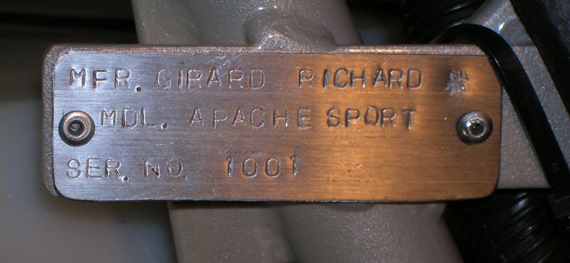

Mike, You didn't mention the DEA tag (they don't call it that, but it is in fact). It must be:
made of stainless steel (aluminum isn't considered fire proof).
It must contain the following information:
Manufacturer
Model
Serial Number
The information must be EXACTLY as it's printed on your registration hard card. You do not have to use anyone's manufactured tag, you can make it yourself. I bought a set of 1/8th steel stamps from Harbor Freight so I could make them as needed and not have to go to an engraving shop. This has been covered in previous posts, and as was noted then, the information on the tag MUST be EXACTLY as it is on the hard card. You can guess why the blob is on the upper right corner of this one from my trike.

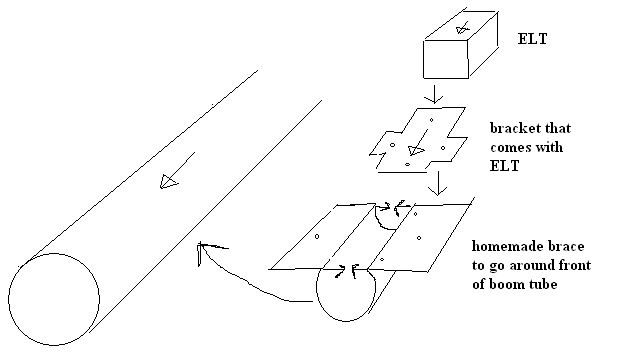

Thanks for the information and pictures Mike. I have a cloth gap seal...don't know where I could put my antenna. My Mark II is fully enclosed but there is no divider between the seats and the gas tanks. Someone suggested putting a brace around the very front of the boom tube and mounting the ELT there and perhaps putting the antenna behind that.
cristalclear13
Joined: 19 Sep 2007
Posts: 363
Location: Southeast Georgia

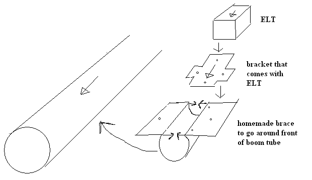

PostPosted: Wed Sep 26, 2007 9:03 am    Post subject: Re: ELT Installation Reply with quote
I've attached a drawing (BTW-I'm NOT an artist or an engineer Smile ) of what I'm talking about.
