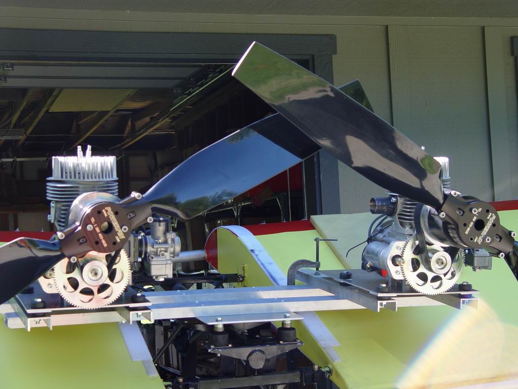

I'm in the process of converting my Firestar 2 to twin Hirth F-33's. I took off my 503, but am keeping it until I'm done testing the twin installation. I have the engines mounted, but still have to work out the throttle hookup, hook up the fuel system, and do the wiring. I'm thinking about two months more.

| Interesting......One prop or two?

Here's a photo of the engines temporarily mounted. The struts are attached to the original mount with Lord mounts. The engines are each mounted on the struts with their own set of Barry mounts.

Looks nice. I wonder what would happen if the belt broke on one engine
while they were in full throttle climbout? A free wheeling prop on one side
and full thrust on the other would sure make it want to twist those struts
and lord mounts. Kirk
