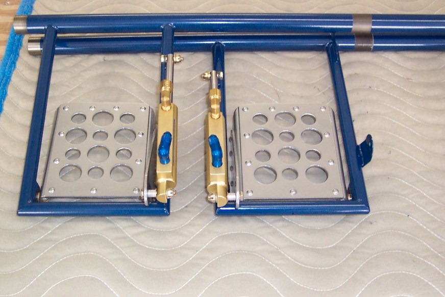

  I chose to powder coat my RV-10 pedals (they look more like chrome in person). I have zero idea how long my pedals will stay in this condition. My white painted RV-6A pedals don’t look bad after 375 hours. Attached are my RV-10 pedals.
Robin ndition10 pedals an from HumidTech

PostPosted: Wed Sep 19, 2007 6:02 pm    Post subject: Brake Pedals Reply with quote
Mark,
What color did you use when you coated the brake pedals to look like chrome? Who does this kind of painting and what is the charge for something like this. BTW they look great. Thx Carl

Thanks Carl, The pedals are powder coated not painted. I selected the chrome color (and the blue) from a list of color choices making sure to select powder coatings that had a high durability rating and had a UV inhibitor component so they would not change color over time when exposed to the sun. Using the powder coating material rated for “exterior” is a good start. As far as cost is concerned that may depend on who you take your parts to however I have found that the biggest cost is the first piece, if you have a selection of 12 parts all the same color it probably will not cost much more than having one piece done since there is a bit of set up involved and spraying 12 parts on a rack is just about as easy as spraying one part. I know there are MANY people on the list more qualified to discuss this process on the list me but if cost is a concern or you are one of the “do everything yourself types” then you can powder coat (PC) your parts yourself relatively inexpensively. I own a manufacturing facility and we set up a PC booth out of half a refrigerator box and coat hangers. One can buy a PC gun on eBay new for $100.00 and the actual powder is inexpensive. The only problem is that a sprayed part needs to be baked in an oven for 10-20 minutes at 350-400 degrees (time & temp specified by powder manufacturer). It is not difficult to get good at this but I warn you that once you start it’s hard to stop powder coating things. Also note that the oven should not be used for food once it has been used for powder coating. I have purchased PC powder from this company for some home furnishing projects. Ebay is also a good source for powder. https://www.pendrypowdercoatings.com/shop/index.php?osCsid=949392b82a9d56a221209d308cdf6b23 Good luck,Robin Marks The pedals are powder coated not painted. I selected the chrome color (and the blue) from a list of color choices making sure to select powder coatings that had a high durability rating and had a UV inhibitor component so they would not change color over time when exposed to the sun. Using the powder coating material rated for “exterior” is a good start.

  Not sure what you are asking, nothing on my -10 has been painted to date. I powder coated all the items you see on the pedal assembly plus I powder coated my steps and the center windshield tube in chrome. While I was at it I PC’d my interior door handles and a custom “dish” in which my fuel valve resides.
  I expect to make 2-3 more trips to the powder coater for the balance of the build.
