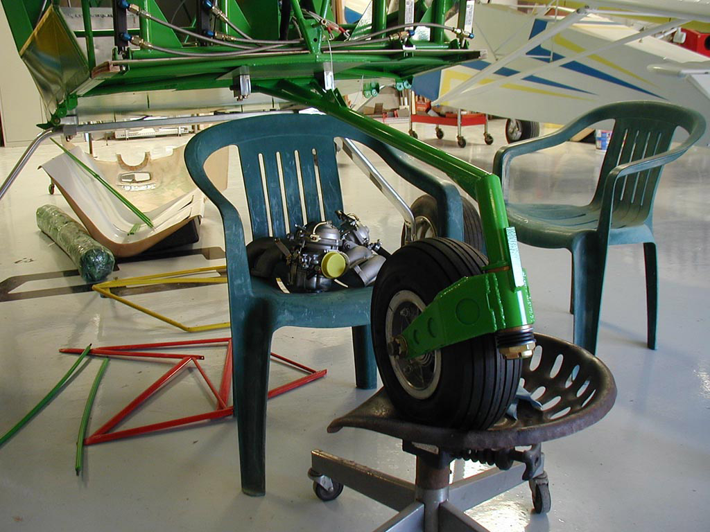

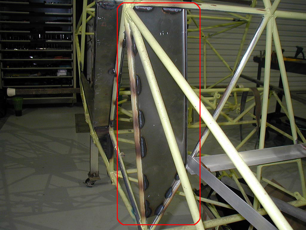

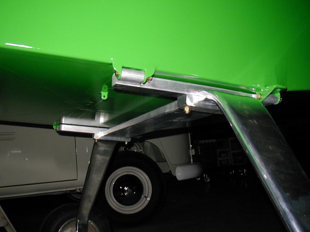

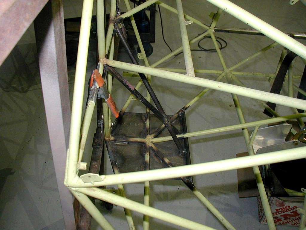

Ernest sez:
I will want to convert to a tri-gear (nose wheel).
Are approved parts and plans available? From who and where? Is this
a complicated conversion? Requiring welding and reinforcement of
fuselage and/or firewall? And will I need to make a decision on
which engine before beginning work on the landing gear?
I think you are on your own as far as plans go, but the process isn't
rocket science. Some welding and reinforcement is required, but I
don't think the engine choice matters at this point unless you plan
to do something truly exotic.
You'll need a mounting plate welded to the tubing just behind the
firewall and you'll need to reinforce the tubing just behind the
seats. On mine, we did this by welding plates between the tubes, as
shown in the attached photos.
The nosewheel assembly was supplied by the factory and the main gear
is from Grove.
Hope this is helpful,
Mike G.
N728KF
Phoenix, AZ

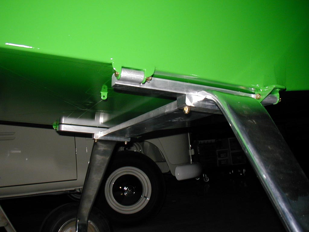

john(at)leptron.com
PostPosted: Wed Sep 19, 2007 6:13 am    Post subject: New subscriber-1st post-request for info Reply with quote
Mike G,
The main gear bracket you show does not look stock, who cut that out for
you? We need something like that for our model 1.
John Oakley

MichaelGibbs(at)cox.net
PostPosted: Wed Sep 19, 2007 11:30 pm    Post subject: New subscriber-1st post-request for info Reply with quote
John asks:
for you? We need something like that for our model 1.
I'm pretty sure that is stock Grove mounting hardware, John.
Mike G.
