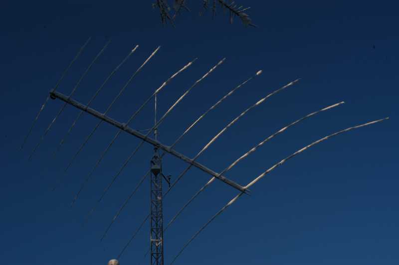

I think my antennas might cause a bit too much drag:
[img]cid:part1.00020908.02090002(at)arrl.net[/img]
The vertical antenna on the top is a tri-band 2m, 6m, and 70cm and encased in fiberglass (15ft. tall); The main antenna is a log periodic 13-33MHz - As for scale, the boom length is just over 30 feet, longest element is 32 feet.
The plane? Oh yeah.... I should get back to that.... Smile
-Jim 40384 do not archive.
