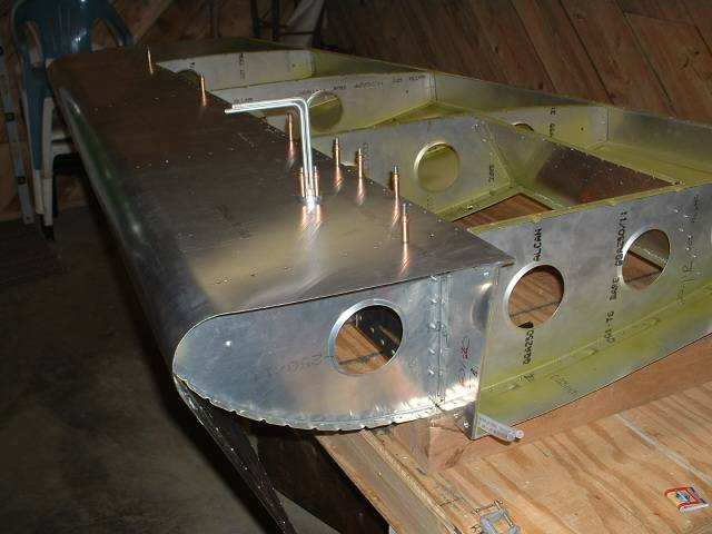

I purchased the Dynon AOA and called them and zenith to get further clarification of the location of the Pitot. Dynon said to keep it out of the boundary layer of air around the wing surface. I think their document said something like 6" away from wing surface. Caleb and I figured the boundry layer wouldn't get much beyond 4" at VNE on the XL. The design distance of the CH pitot has the stand off at 2.5 for the static tube and 3.5 for the pitot.
I just measured the Dynon AOA on the wing I am building and I have it set 5.75" from the wing surface to the center of the pitot hole. That should keep it out in the undisturbed airflow. The rest of the position is just like the print 150mm back from the wing spar rivet line, and just outboard of RR#5.
Planning to mount the two static ports just like Mark Townsend said. It works for him it will probably work for me also Laughing
