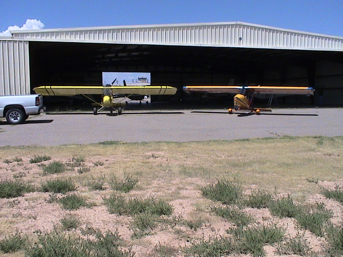

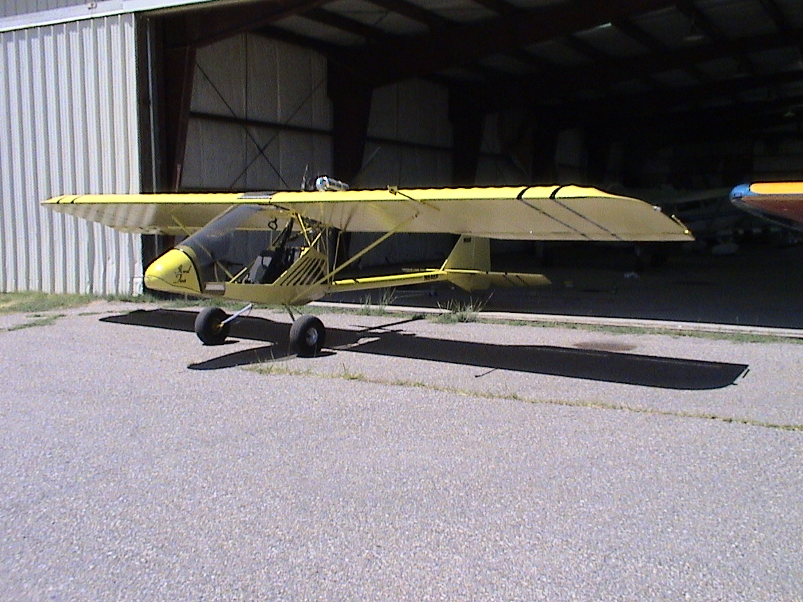

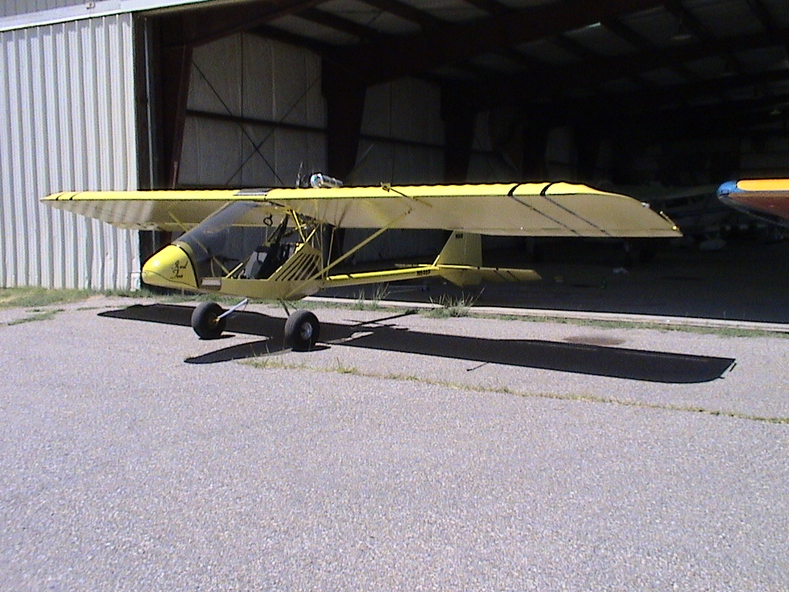

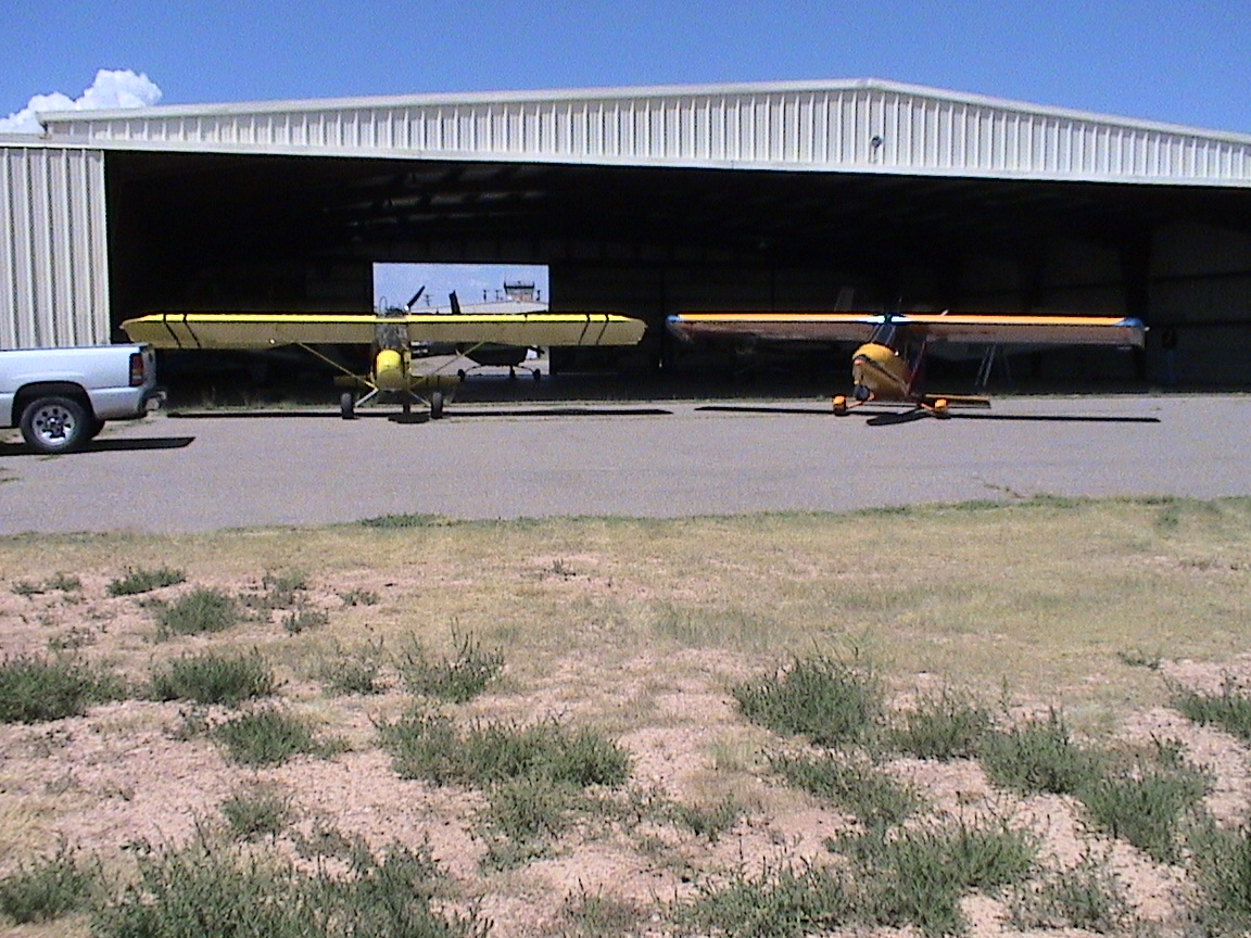

I've attached a couple photos of my two planes, two of the finest light a/c types you can get, IMO - the titan for go-fast, zip around, high-performance mission, and the Kolb for the magic-carpet ride mission.
Truth is, I can't identify any particular reason why I like the Kolb design so much. It's probably the construction, the folding wings and the fact that it's tailwheel. The entire airframe uses traditional aviation construction, nothing junky or screwball on the entire plane. The covering used is the Stitts process which pretty much lasts forever and there are very few wear points on the plane.
Personally, if I were going with a big Kolb, I'd do the Kolbra, mainly because of the tandem seating and what appears to be a little less wing area (so it might be less affected by the wind). It looks like the view is a little better in the Kolbra from the front seat. But I still have yet to fly in either of the big Kolbs, so I can't really make an informed judgement there....
LS
