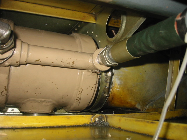

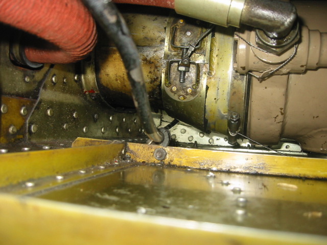

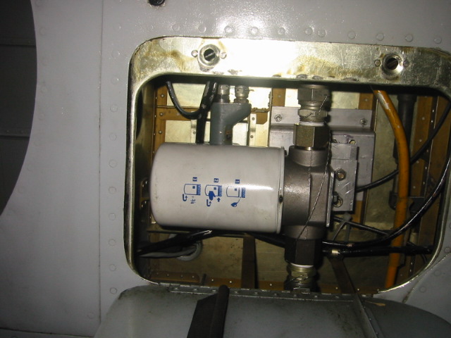

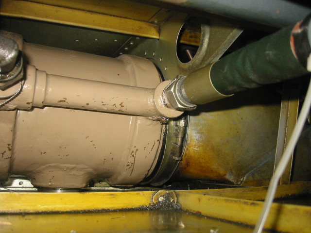

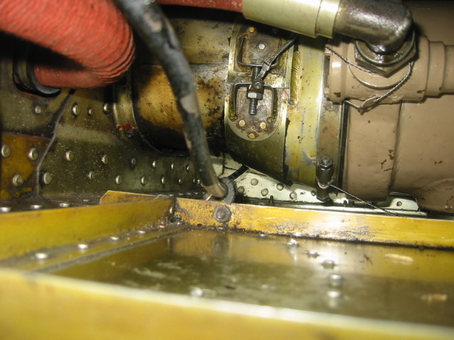

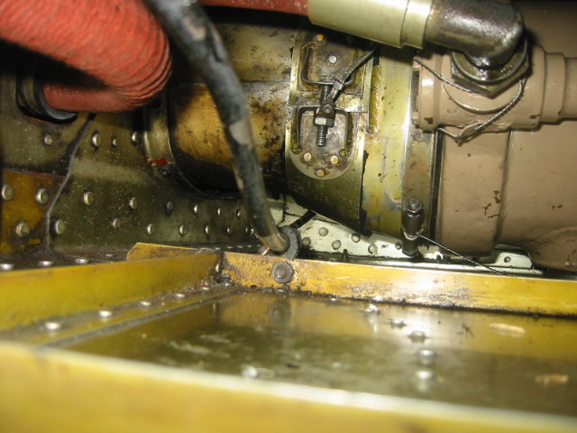

I have been using the Marion filter for 65 hours engine time and find no fault. In fact, the placement that I choose makes it easy and clean to change the filter and oil. It also helps the CG location. I bought the filters from Craig a couple of years ago. Initially, Craig didn't have the mount for the filter, just the filters. And cheap. The filter needs to be place on the oil line that is from the output side of the pump. Taking the input line off the oil cooler and swinging it 90 degrees to port gives you an idea of were to place the filter. All that you need is another short oil line from the filter to the cooler. Doug or Craig can help with that. This new line needs a 90 degree fitting and one straight fitting.I have attached some photos of the belly placement that I used. The mount that I used has a 25 lbs. by-pass valve. Ask Craig if his has the same.
