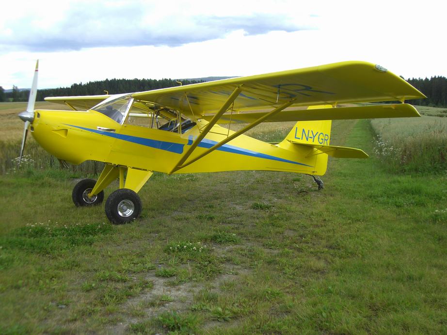

It flew. My instructor took it to the air for a 20min flight today, and he was thrilled. Flew hands off with just a little bit pitch trim, and he was very pleased with the handling . He was reporting 100mph cruise with only 2600rpm of the Jabiru 2200 engine.? (think I have to check my ASI). The weather was not that good for a test flight, it was 10knot and some rain, hopefully the weather is better in a few days, Will come back with more numbers later.
Geir Olav
Kitfox 4-1200 (Speedster wing).

| Quote: | He was reporting 100mph cruise with only 2600rpm of the Jabiru 2200
engine.?
Congratulations, Geir! I am sure you'll have a lot of pleasure with
your Kitfox - Jabiru combination. I also fly at 2600 RPM on cruise but
it is more like 90 MPH. Your ASI might be slightly wrong. Going from
the Rotax 582 to the Jabiru, I noticed that the air vent under the
cowling, ahead of the firewall was creating a slight low pressure in
the cockpit and I had to put my ASI to a static port, aft on the
fuselage. Maybe you could check that. Another thing is that maybe your
prop has a coarser pitch than mine. What is you static WOT RPM on the
ground? Anyway, with my model 3, 100 MPH is the Vne so I am very happy
cruising at 90 MPH.
Cheers,
Michel Verheughe
Norway
Kitfox 3 - Jabiru 2200

The static rpm is 2950 (it is not the best choice propeller on this
engine/airframe) but I will test if for a while.
I think that 2950 is right in the bullseye, Geir, and if you cruise faster than me, it can be one of two reasons:
1) Your indicated air speed is not your real air speed. You may need a static port line, or
2) Your model IV is more streamlined than my model III.
I'll contact you privately regarding us meeting in Norway.
Cheers,
Michel Verheughe
Norway
PS: I've just got a note from a veterinary opthamologist asking me to - please stop aiming for the bullseye! - but ... okay, okay I'll shut up!

The wing on the model IV-1200 has the new faster airfoil, vs the draggier
undercambered (Avid) airfoil used on the model 1-3 Kitfox. So I wouldn't be
surprised to know the IV will cruise 10 mph faster.
Congrats on your test flight Geir! Nice looking airplane that sounds like
it should ba real screamer!
Paul Seehafer
Model IV-1200 912ul Amphib

I believe that Geir also reported that he was flying a Speedster wing which would be faster still.
