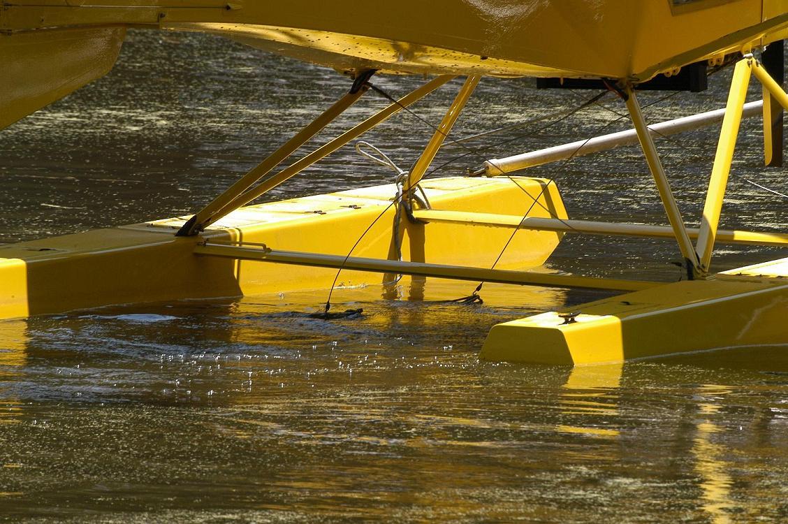

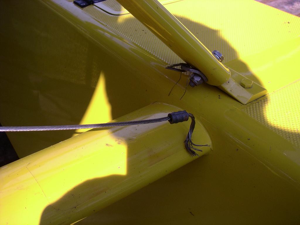

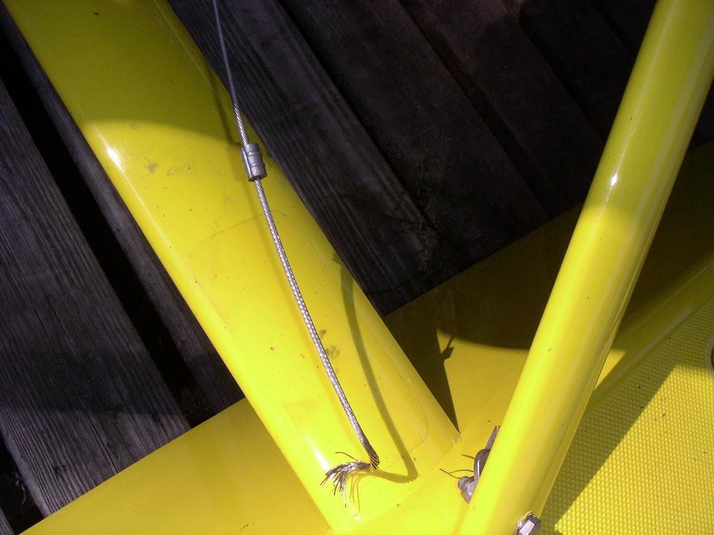

Do not fly your Aerocet 1100 floats without reading this carefully first!
Recently I had two of the cross brace cables fail on my Aerocet floats because the nicopress sleeves slipped on the cable, caused by not being crimped properly when manufactured. Needless to say, when you lose the cross bracing on your floats, it's the equivelent of losing the bungee chords and safety cables from a bungee style landing gear. All worked out ok for me, but I fear what may have happened in a different scenario.
So for anyone flying aerocet floats on their Kitfox or Avids, please check your nicopress fittings to make sure they are crimped properly. You will need a nicopress go/no-go gauge to be able to tell if they are good or not (a $6 tool). If in doubt, re-crimp or replace them. Without good crimps your floats will sooner or later fail! And even if you have a lot of landings on your floats (mine had hundreds and hundreds), it's just a matter of time before the floats will collapse in operation. Most likely this will happen when subjected to a higher than average load (in my case it was caused by a very large boat wake).
I have since been told that Aerocet had a service bulletin about this problem, but I wasn't aware of it until after mine failed.
I don't want to see anyone get hurt, especially knowing there is such an easy remedy to the problem.
