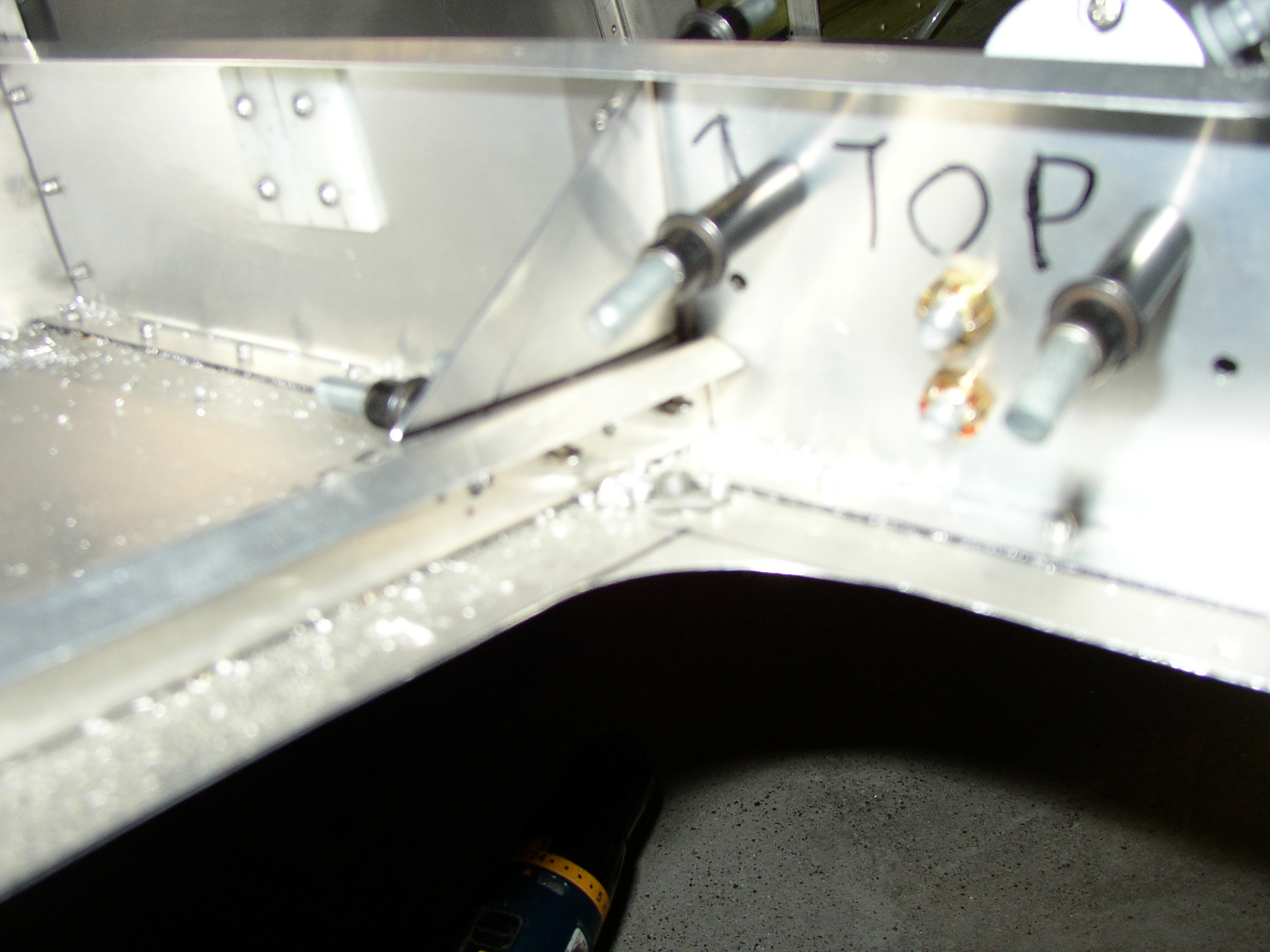

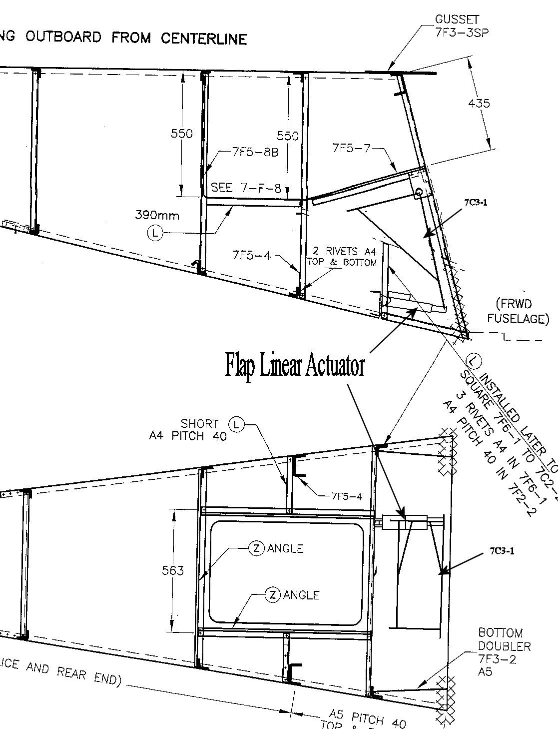

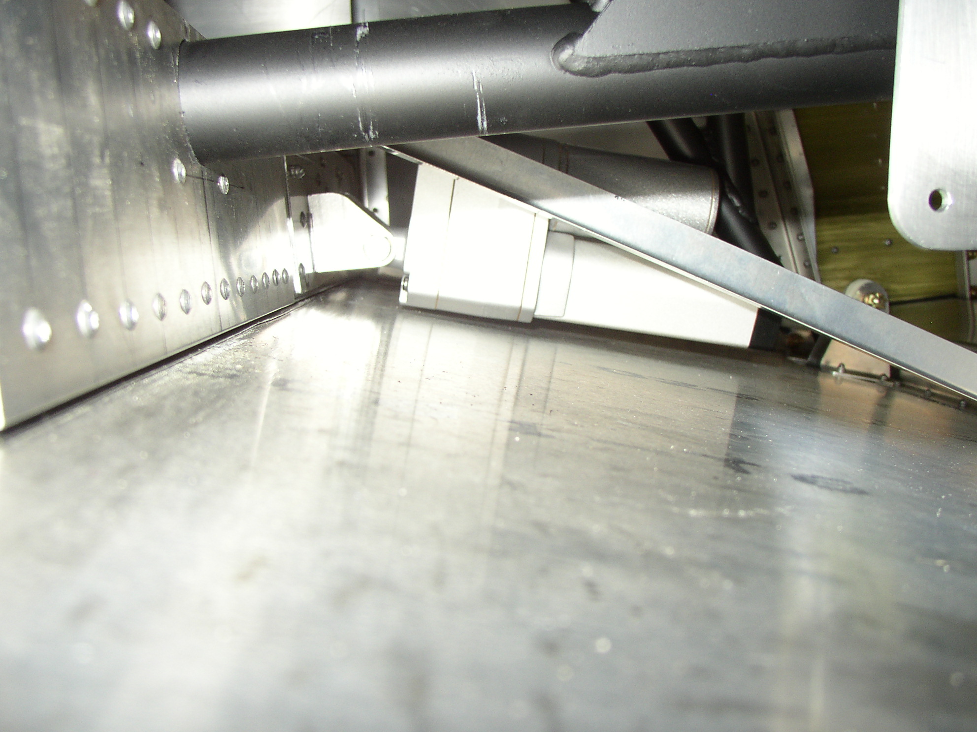

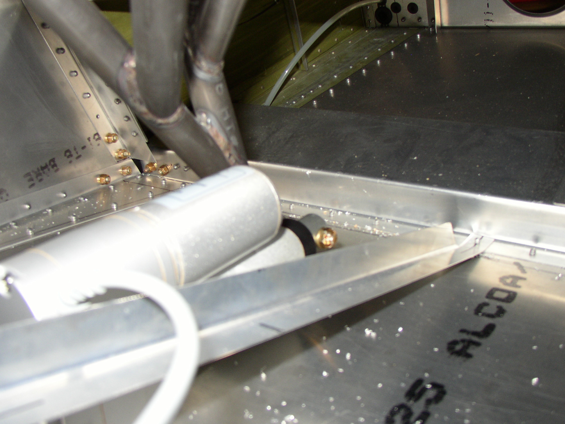

I decided to mount the flap motor on the front of 7F6-1 in line with the bottom of the flaperon control mount. It is bolted to the Flaperon control mount with an AN4-20 in the same place the flaperon control lever would normally go. The position is ideal because it allows easy access and maintenance to the motor through the rear access panel. I ran the idea past ZAC and they suggested adding a doubler to reinforce the channel 7F6-1 and a gusset between 7F6-1 and the z bracket around the access hole. This is to prevent twisting of the channel during flap operation.
I'll try to send pictures and the plans I sent to ZAC, although they're not that great. Good Luck on your project.
