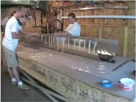

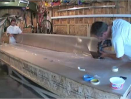

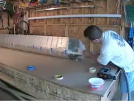

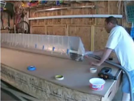

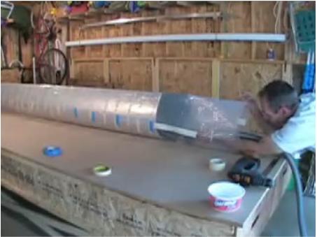

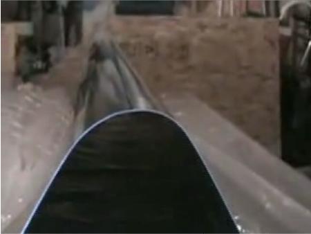

<?xml:namespace prefix="v" /><?xml:namespace prefix="o" /><![endif]--> For some reason, Youtube and I don't get along There is a systwem flaw between the keyboard and the chair. Could someone who's seen the video give a brief verbal rundown on how they do it? Thankya, thankya ver'much.
Paul Rodriguez
601XL/Corvair
larry(at)macsmachine.com
PostPosted: Sun Aug 12, 2007 11:07 am    Post subject: Scratchbuilders - Leading Edge Skin Vacuum Forming Reply with quote

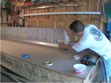

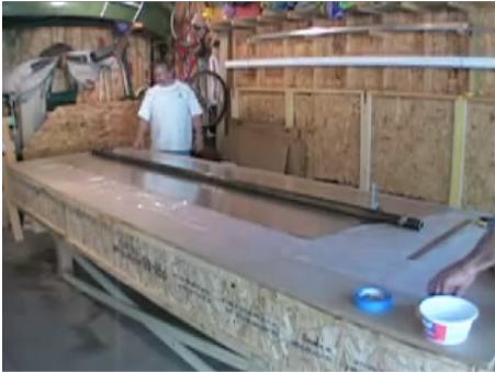

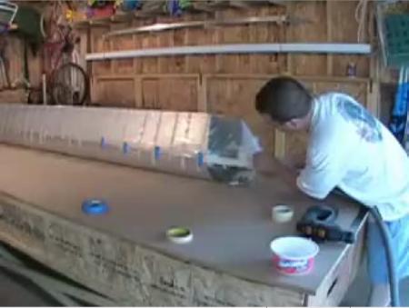

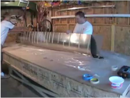

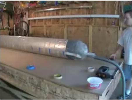

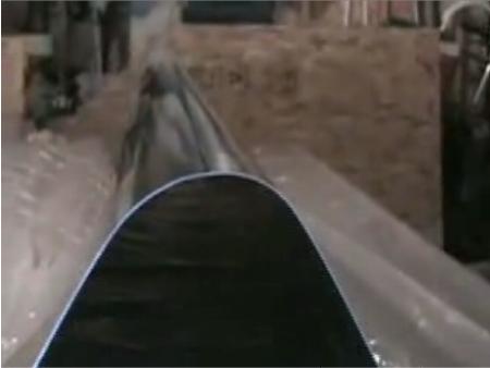

Hi Paul,

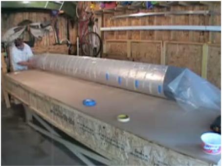

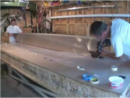

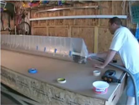

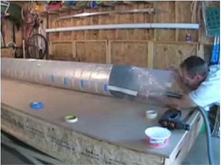

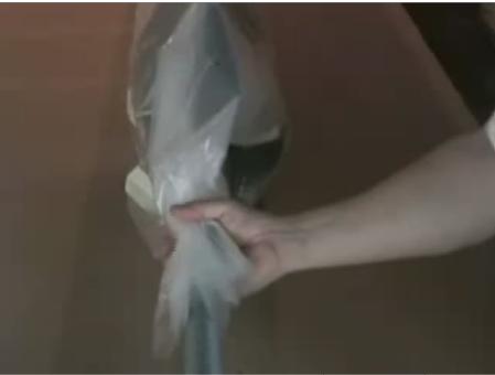

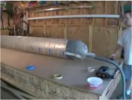

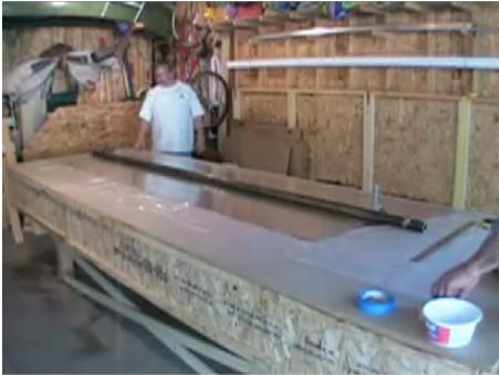

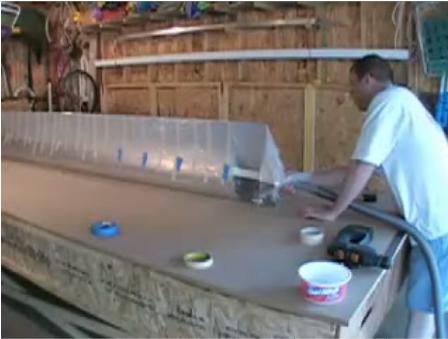

The U-Tube nose skin bending routine starts by placing a 4-mil plastic
on the worktable.
Then the skin is placed at center of the plastic with excess plastic all
around. A piece of pipe longer than the skin is placed exactly at the
center of bend. The pipe is screwed to the table with brackets to secure
position. Edges of the skin are lifted and taped edge to edge and
progressively shortened to bring the skin to a “canoe” shape. The
plastic is pulled up around the skin and taped to seal the overlapping
edges. The ends are closed and a vacuum is used at one end to suck out
the air and bring the sides together. The amazing part is the ability of
the vacuum to pull the skin tightly around the pipes diameter. The
vacuum is held for a few seconds and then everything is reversed
allowing the skins to spread slowly and the tapes are removed. The bend
makes a 70-degree or so angle between the skins and does a remarkable
job of uniform bending.
I did a larger radius type press arrangement, but for the thinner wing
of the XL, this is just the ticket. One could do a piece just 36-inches
long to sample the process and get the radius right.

Paul, see images attached - I am posting on the forum so it won't bother regular email subscribers.

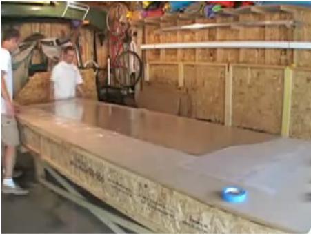

PostPosted: Sun Aug 12, 2007 12:15 pm    Post subject: Scratchbuilders - Leading Edge Skin Vacuum Forming Reply with quote
Gents, David and I spent almost 6 mos trying different processes in which to form the nose skin for our 601’s. We worked on hydraulic systems and vacuume setups and many others. But when it comes right down to it we found a simple, no-cost solution and posted it here on www.ch601.org .
Link is here
http://www.ch601.org/resources/Nose%20Skin/bending_a_nose_skin.htm
