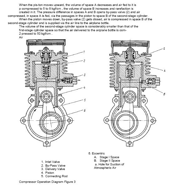

I appreciate all the input. I'm attaching a diagram of the compressor for those who are following but don't have one at hand.

And we always thought the USSR were inferior and simple minded! It has been
awhile since I looked at the diagram but danged if it is not complicated!
Anybody converted the gear on the YAK to hydraulics? It would put a stop to
all this carboned bypass valves and clogged snot valves but bring on its'
set of headaches. At least they would be self lubricating though.
Doc
